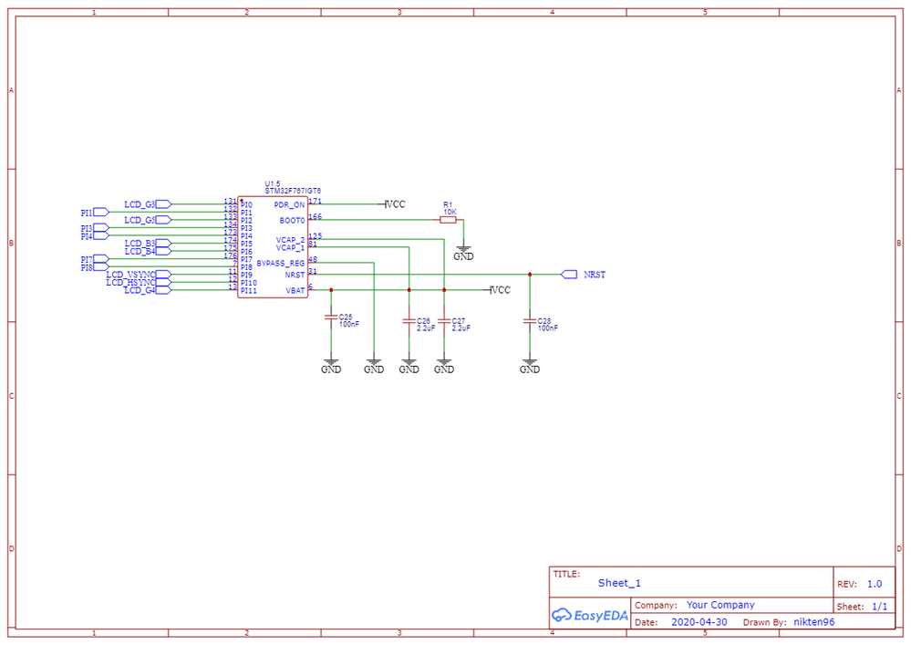

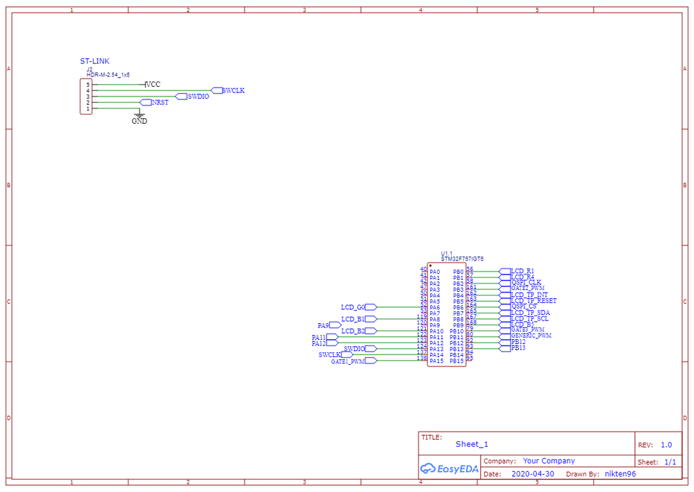

i created a custom board which foundamental schematic is like the images:
I'm using the classic ST-LINK USB Debugger but i can't debut nor upload my code inside my STM32F767IGT MCU, both with STM32CubeIDE and STM32 ST-Link UTILITY.
In the utility the error was
19:34:31 : Can not connect to target!
                  Please select "Connect Under Reset" mode from Target->Settings menu and try again.
                  If you're trying to connect to a low frequency application , please select a lower SWD Frequency mode from Target->Settings menu.
19:34:32 : No target connected
or
19:33:54 : Can not connect to target!
                  If you're trying to connect to an STM32W1xx device, please select Normal or HotPlug mode from Target->Settings menu.
19:33:55 : No target connected
while in STM32CubeIDE
Error in initializing ST-LINK device.
Reason: Unknown. Please check power and cabling to target.
or
Reason: ST-LINK: 51FF6B064883535241202187 not found.
or
Reason: No device found on target.
What should i do to keep my custom board work?
Typically each should be individually wired to own capacitor. Expect 1.2V on these pins
Definitely not connected to VCC
3 REPLIES 3
Guru
VCAP_1 and VCAP_2 should not be connected to VCC. Even if you fix this, the chip may be dead since the voltage on those pins is normally around 1.2V.
Perfect, it works now! Thank you!
