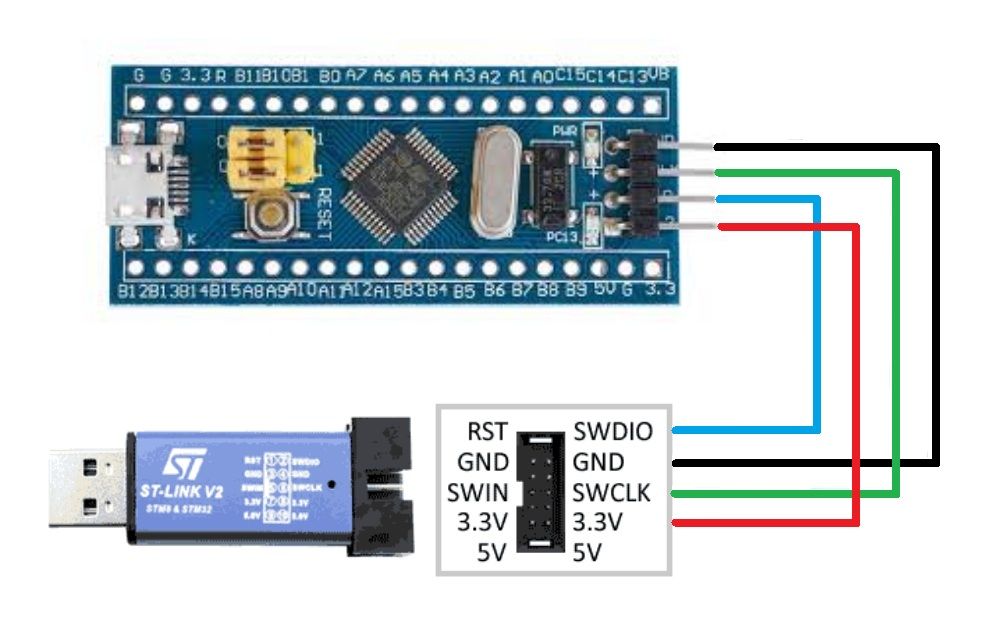

This error has to do with the ST-LINK interface that is not working. There are 2 reasons (that I know of) that can cause this:
1. Your connections between the ST-LINK and Blue Pill board are not correct.
Have a look at the attached image and check the connections.
Note: Your Blue Pill will now be powered with the 3.3V from the ST-LINK.
Warning: Never power the Blue Pill from more than one source. Example; do not plug in the USB on the Blue Pill when 3.3V from the ST-LINK is connected. If you do want to power from the USB, then first disconnect the 3.3V from the ST-LINK. The YouTube video below is done like that.
2. You have flashed a program to the Blue Pill that does not have the SWDIO and SWCLK pins on the MCU enabled. (Did not select Serial Wire – Debug).
If you do this your program will run only once. The second time you will be locked out.
Then the only way to get past that is to select Serial Wire – Debug in your program and then flash it by going the BOOT0 – route.

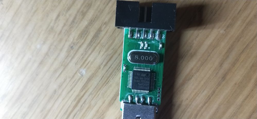

‎2021-01-24 11:31 AM
hi Over their,
I am also same error and as u mentioned about Clone MCU's
I opened my STLINKV2 red case and it has ST32F103C6 IC only.
But still getting this GDB error issue.
So when u are saying about CKS32F103, u mean the IC which is used by STLINKV2?
between i am not able to figure out how did u check your id code for your MCU
‎2021-01-24 5:30 PM
No, it does not matter what MCU is used in your ST-Link.
The issue is with a clone MCU on your “Blue- pill�?- board.
When using STM32CubeIDE to compile your program, it will not work.
Then you have to follow the steps in my original post to fix the problem.
