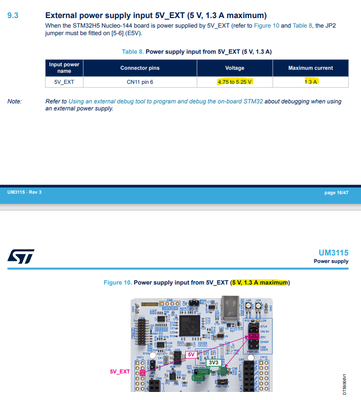

I was using Nucleo-h563zi board in which my application was to run it using external power source so for that i shifted the jumper to E5V to power the board usign external 5V. I was using AMS1117 voltage regulator to convert it to 5V from 12V but accidentaly due to failure or it 12V was given to E5V pin after the LD4 and LD6 led is red and the LD5 is not turning on as usual when the jumper is shifted to STLK for programming.
After this when i try to program by changing the jumper to STLK it is detected but while uploading it is showing "No stlink device found"
i found that the 5V,3.3V is shot circuited. what is the possible reason and how to repair it.

Hello @Shubham08;
According to the UM3215, the E5V supports a voltage from 4.75 V to 5.25 V and a maximum current of 1.3 A. I think 12 V is very high. If these conditions aren’t respected, you risked damaging the board and the STM32MCU "The impact when STM32 MCUs operate above the absolute maximum ratings".

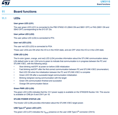

For the LEDs color means:
LD4: Red LED ON when the initialization between the PC and STLINK-V3EC is complete.
LD5: The green LED (LD5) indicates that the +5 V power supply is available on the STM32H5 Nucleo-144. This source is available on CN8 pin 9 and CN11 pin 18.
LD6: The tricolor LED (LD6) provides information about the STLINK-V3EC target power.
