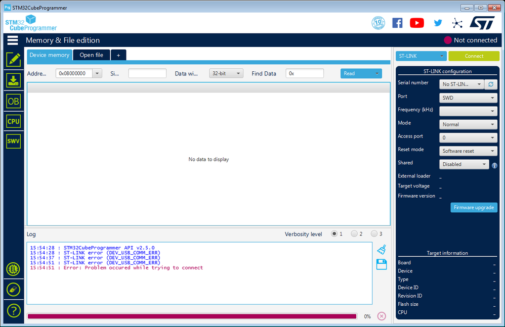

I have a Project using STM32H745XI Micro Controller , I have followed previous known steps to Generate Source code using STM32CubeMX for STM32H745XI.
I have sucessfully built the files using the STM32CubeIDE for STM32H745XI Discovery Kit , I am not able to Debug the souce code connecting with using ST-Link on the Discovery Kit . Is there any special settings that needs to be taken care other than the following .

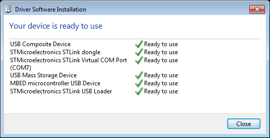

 I have installed the ST-Link Driver from the following link
Open On-Chip Debugger 0.10.0+dev-g30d1303 (2020-06-18-09:13)
Licensed under GNU GPL v2
For bug reports, read
http://openocd.org/doc/doxygen/bugs.html
stm32h7x_cti_prepare_restart_one
Info : Listening on port 6666 for tcl connections
Info : Listening on port 4444 for telnet connections
Info : connected to stlink-server
Info : stlink-server API v1, version 1.3.0
Info : STLINK V3J3M2 (API v3) VID:PID 0483:374E
Info : Target voltage: 3.274320
Error: init mode failed (unable to connect to the target)
The interface firmware FAILED to reset/halt the target MCU

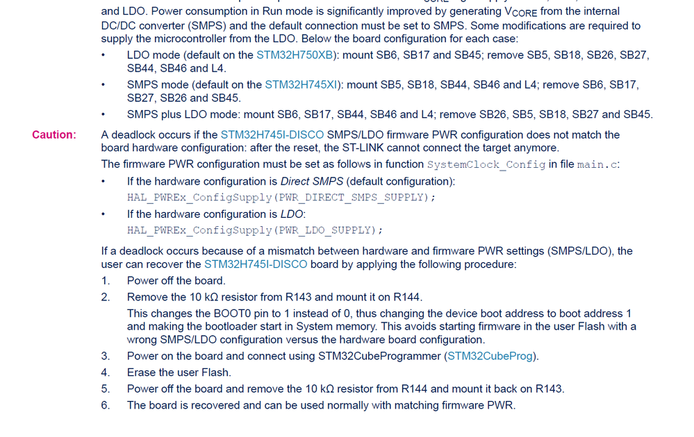

Yes the STM32H7 was Bricked , I am able to now recover the board 10K resistance De-Soldered from R143 and Soldered on to R144 .( There should have been an Jumper provided or ,,, the ST-LINK should have had GPIO method to recovered the board )
0693W000004Jt3OQAS.pngAfter Going through the user manual it is mentioned in an Caution: :sad_but_relieved_face:

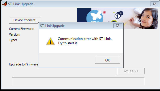

From STM32CubeProgrammer interface, try to perform a Firmware upgrade. Is that possible?
Does it resolve your issue?

Seems more likely that the H7 is bricked with user software, and the ST-LINK here isn't switching to DFU/Update mode. Don't think this board provides jumpers to disconnect SWDIO/SWCLK from the target.
