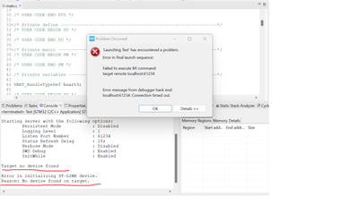

Hello I can't able to connect my NUCLEO - H7A3ZI -Q. Its showing error while commenting.
Please help me with solving this issue.

Hello @Durgasish and welcome to the ST Community :smiling_face_with_smiling_eyes:.
the STM32 ST-LINK utility is now obsolete. Could you please try using STM32CubeProgrammer. Also, don't forget to use a data and not a charging cable.

Hello @STTwo-32  if I'm using in STM32Cube IDE also I'm getting similar issue.
Could you try to perform a mass erase of the board using CubeProgrammer. Then, restart CubeIDE and retry to connect.
Also, make sure that your ST-Link firmware is upgraded, check the jumpers, SWD pins status, try configuring the "Connect under reset" mode and dont forget to check your power supply and try to change your USB cable (ensure that you are using a data cable not a charging one).

Are you sure the board has not used or/and modified by someone else ? Do you have another board and connect with STM32CubeProgrammer?
No It is not modified by anyone. And yes I have checked it with another NUCLEO H743ZI its working fine for that board.
