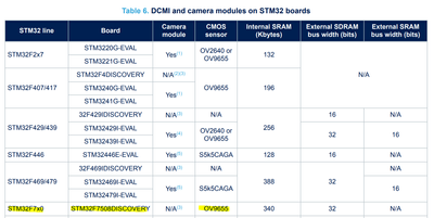

You can used with STM32F7058-DK board a OV9655 CMOS sensor as mentioned in table 6. in AN5020.
This sensor is used and tested in this example: Camera.

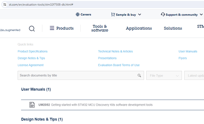

Andrew Neil
@KDJEM.1 @mƎALLEm - why is there no User Manual for this board?
The only thing on the Product Page is the generic software tools manual - and that's long out of date:
This is the second question today about this board which should have been answered in the User Manual!
EDIT
I see that the board is obsolete - I hope you're not removing documentation for obsolete products?
The recommended replacement, 32F746GDISCOVERY, also references that woefully out-of-date software tools manual - isn't it about time that was updated?
@Andrew Neil ,
UM2470 is back on the product page :).

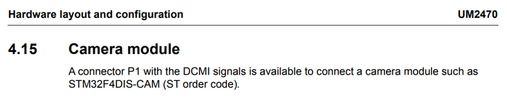

Sule_Akcay
Using the OV9655 sensor, STM32F4-DIS-CAM and STM32F7508-DK board can be connected together.

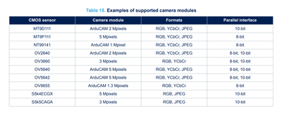

Sule_Akcay
Other camera models that can be used with the STM32F7507-DK card:
