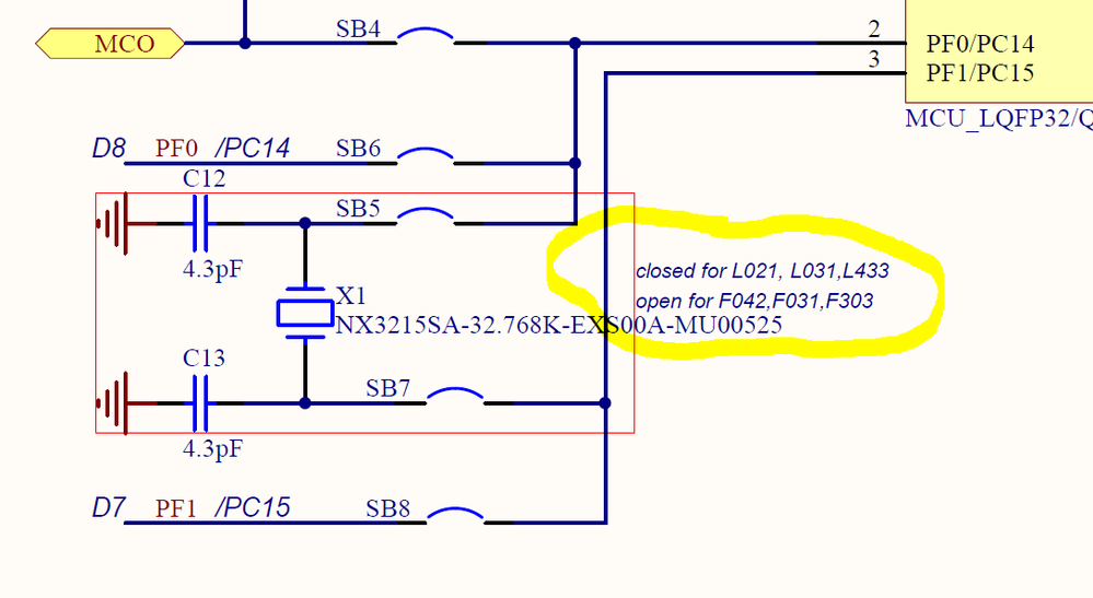

Bug in STM32L432KC Nucleo resources
godlyblade
Refer to this download page.
In package: en.nucleo-32pins_bom.zip
Everywhere in the document, the wrong uC is mentioned (L412KB)
In package: en.nucleo-32pins_sch.zip
The options for the external oscillator are not shown for STM32L432 (see image)
It seems, that the resources are just copied and pasted... It would be great it anyone could correct these issues.
Best regards!

Amel NASRI
Hello @Pascal Schröer​ ,
Please note that these resources are shared by all Nucleo 32pins boards.
Your comments are reported internally for farther check, if there is any required update to do.
-Amel
