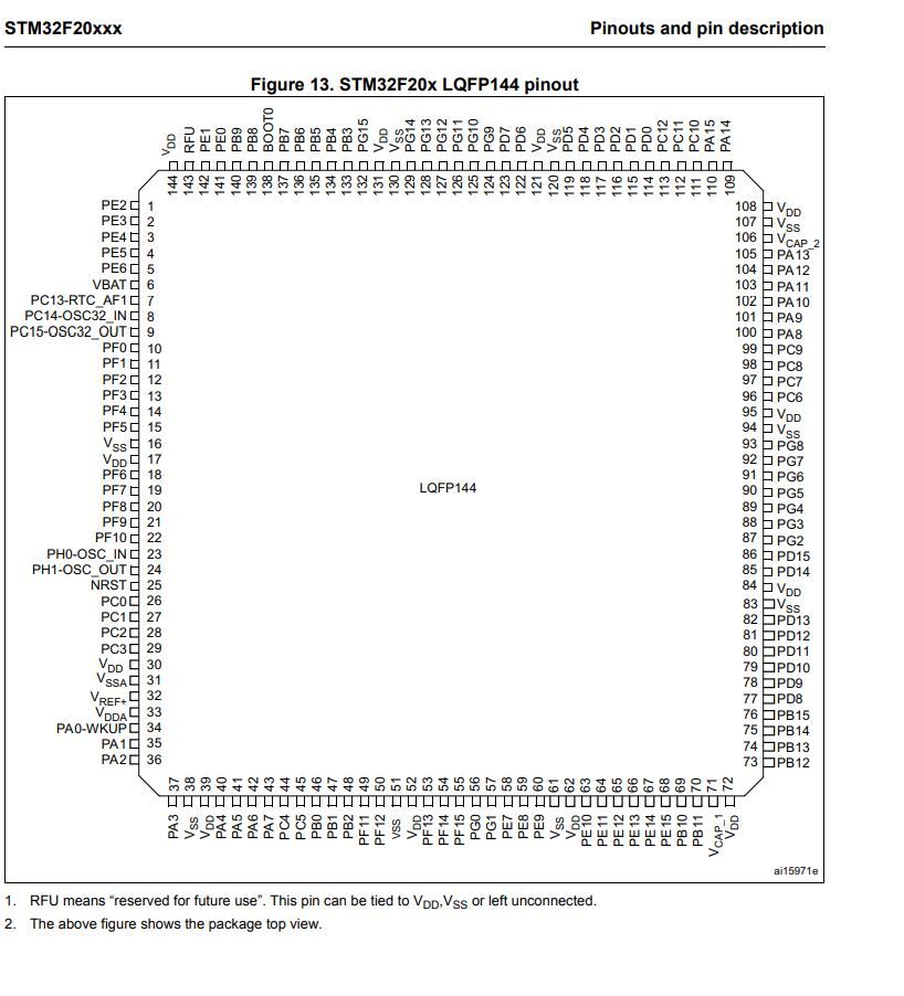

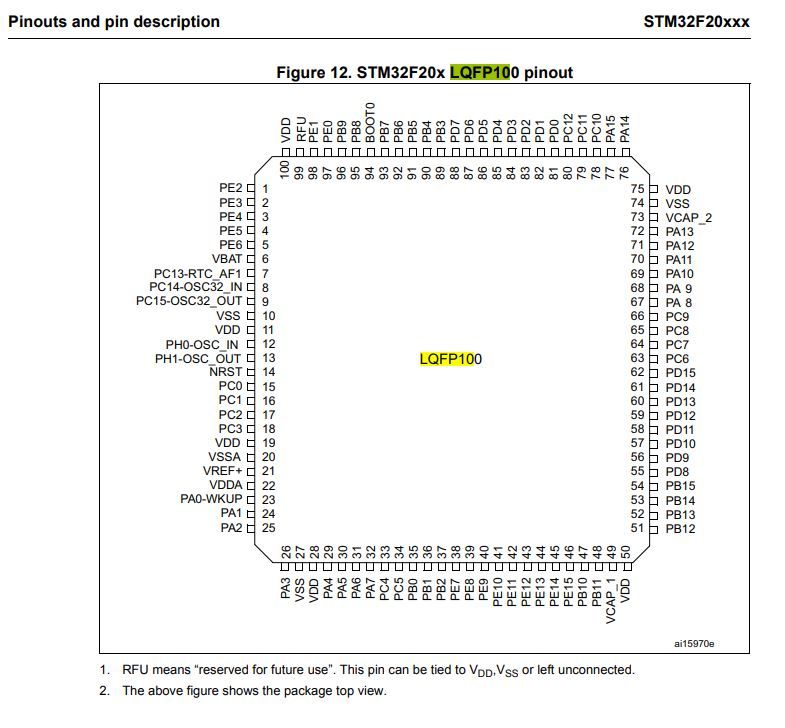

I couldn't find STM32F205VEFT in stock, so I modified the board and used STM32F205ZET6, but the board doesn't work as well as it did before the revision. I would appreciate it if you could tell me the possible causes for reference.

The STM32F205VETx is an LQFP100 package, and STM32F205ZETx is LQFP144 package.
So, you should refer to the STM32F205xx Datasheet and check the GPIO, pin assignment.
You can use STM32CubeMX to compare the part numbers.
For that, this FAQ may help you: How to compare different STM32 part numbers using the cross selection tool of STM32CubeMX?
Check also the STM32F20x Errata sheet, if you have the limitation as described in the doc.

We wanted to be able to put both 100-pin and 144-pin components on the board, so we designed the board as shown in the attached document.
I ran a pattern through the pins that had the equivalent functions of the 100-pin and 144-pin components, and dropped all unused pins of the 144-pin ones to ground.
This prototype board uses the 144-pin one, and the firmware is the program that was used when the 100-pin one was used.
