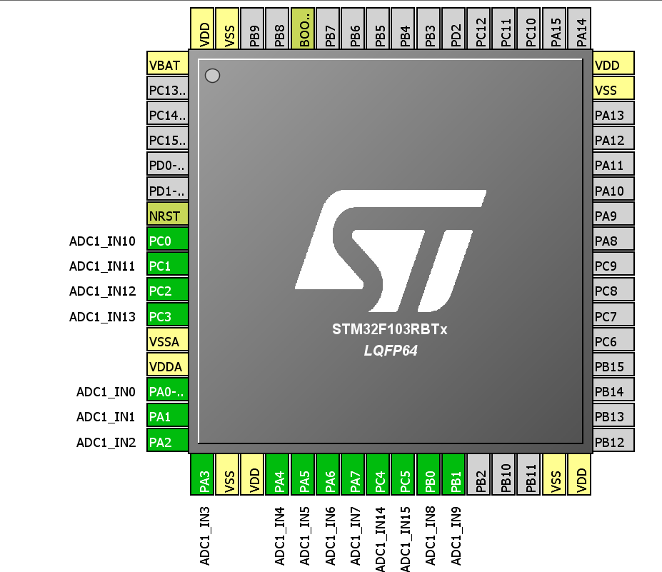

What are the GPIO Pins for ADC 1 in STM32F103RB? I can't find it in reference manual.

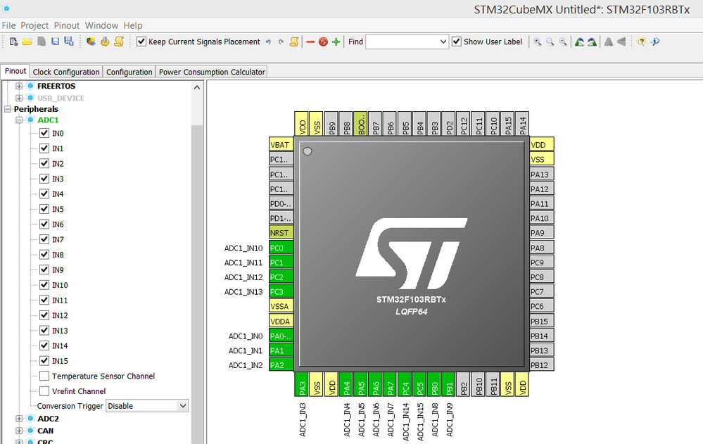

If you have problem reading datasheet try CubeMX, select the device and enable ADC 1 pins:

Pin functionality is enumerated in the Data Sheet, not the Reference Manual
