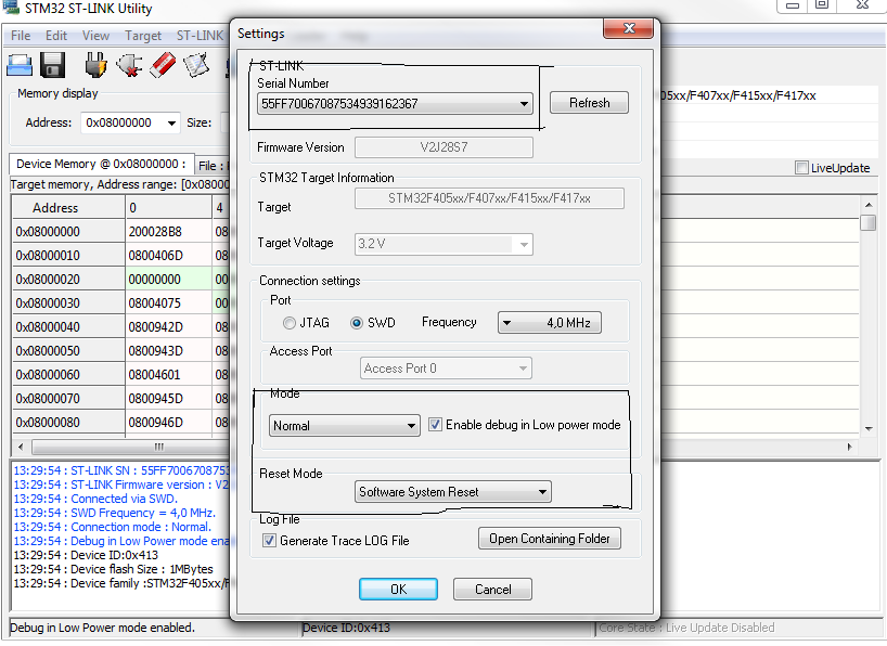

Posted on May 04, 2018 at 22:40
I had the same issue couple of months back. Try this setting for ST- utility and see if it works.
Also, measure your voltage across Vcap1  and Vcap2.It should be 1.26V. If Vcap1/Vcap2 is <1.26, then your ST-link is unable to detect your target.
