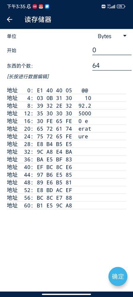

I have programmed the temperature sensor, but it seems that it has not been successful, the NDEF reading result is shown in the figure, what should I do?

Brian TIDAL
Hi
I see several issues in your code:
  1. the input parameter of NDEF_WriteNDEF is supposed to be a formatted NDEF buffer whereas temp_data is not a NDEF buffer. If you want to write a TEXT record, make sure to use the NDEF_WriteText API.
  2. obviously MAX6675_ReadTemperature returns 0. You should debug this API
  3. memcpy(temp_data, temp_str, strlen(temp_str)) seems to be useless. Why don't using temp_str direclty?
I would also remind that this community has ground rules so please make sure to avoid to duplicate your posts.
Rgds
BT

Schuyler
Senior
Hi,@Brian TIDAL_O​
I am a beginner,so can you give me more information about NDEF_WriteText API?I read out the memory through the following code as shown in the image,but I don't know why is it displayed like this?I need your help�?Thanks

Brian TIDAL
in a nutshell, an NDEF message is a set of NDEF records. Each NDEF record carries a payload identified by a payload type (e.g. TEXT, URI, etc.).
NDEF_WriteNDEF is designed to write a buffer containing an NDEF formatted message. In your case, the content of NDEF_WriteNDEF buffer is not an NDEF message but the payload with the temperature value as a text. As the temperature value is a text, the proper API to be used is NDEF_WriteText (see description inside lib_NDEF_text.c). NDEF_WriteText encodes the payload into a TEXT record and then writes this NDEF buffer thanks to NDEF_WriteNDEF.
What you currently have in the tag memory is:
block 00: E1 40 40 05: Capability Container
block 01: 03 0B 31 30: NDEF TLV (T=03h, L=0Bh, V= 31 30 39 32 2E 32 35 30 30 30 30 etc.)
block 04: xx FE xx xx : Terminator TLV
Here the V-field (31 30 39 32 2E 32 35 30 30 30 30) is the payload whereas it should be the encoded TEXT message. If you use NDEF_WriteText, the V-field will have the proper TEXT message format
Rgds
BT

Brian TIDAL
when the NDEF TEXT message is properly formatted, Android displays the text (i.e. decodes the NDEF and extracts the payload). If using the ST25 NFC Tap app, the NDEF tab display "Text record"; the content of the record is displayed when pressing on the "Text record" field.
The memory content will be:
block 01: 03 11 D1 01: NDEF TLV (T=03h, L=11h,
block 02: 0D 54 02 66 V=D1 01 0D 54 02 66 72 31 30 39 32 2E 32 35 30 30 30)
block 03: 72 31 30 39
block 04: 32 2E 32 35
block 05: 30 30 30 FE: xx xx xx FE Terminator TLV
V-field decoded:
D1                           Record header, TNF=001
   01                        Type Length
      0D                     Payload length
         54                  Type: T (Text)
            02 66 72       Text lang = en
                                 Text = 1092.25000
Rgds
BT
