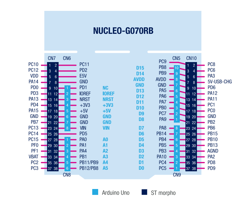

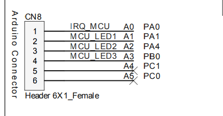

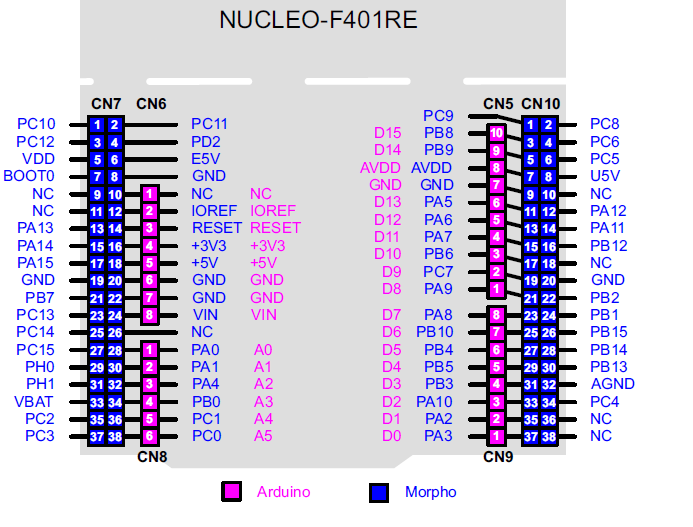

Hahah, It was good journey :D I think that manual of NFC board is customized for few boards with the same pins .e.q F401, L476 etc. .... and You on other board must check and correct eventually differences. For example:
_legacyfs_online_stmicro_images_0693W00000biwh9QAA.pngMCU_LED3 on dedicated boards is PB0, look on F401:
_legacyfs_online_stmicro_images_0693W00000biwhEQAQ.pngbut on G0xx you have PB1:

My advice. Undo all changes. Start from beginning and change only main.h:
#define B1_Pin GPIO_PIN_13
#define B1_GPIO_Port GPIOC
#define IRQ_3911_Pin GPIO_PIN_0
#define IRQ_3911_GPIO_Port GPIOA
#define IRQ_3911_EXTI_IRQn EXTI0_IRQn
#define LED_F_Pin GPIO_PIN_1
#define LED_F_GPIO_Port GPIOA
#define LED_B_Pin GPIO_PIN_4
#define LED_B_GPIO_Port GPIOA
#define LED_A_Pin GPIO_PIN_0
#define LED_A_GPIO_Port GPIOB
#define LED_FIELD_Pin GPIO_PIN_8
#define LED_FIELD_GPIO_Port GPIOA
#define TMS_Pin GPIO_PIN_13
#define TMS_GPIO_Port GPIOA
#define TCK_Pin GPIO_PIN_14
#define TCK_GPIO_Port GPIOA
#define SWO_Pin GPIO_PIN_3
#define SWO_GPIO_Port GPIOB
#define LED_V_Pin GPIO_PIN_4
#define LED_V_GPIO_Port GPIOB
#define LED_AP2P_Pin GPIO_PIN_5
#define LED_AP2P_GPIO_Port GPIOB
#define SPI1_CS_Pin GPIO_PIN_6
#define SPI1_CS_GPIO_Port GPIOB
