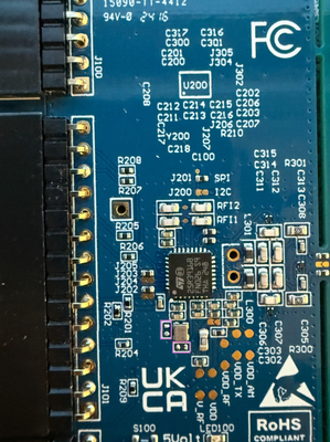

I recently added ST25R3916B to a board.  I followed the evaluation board schematic pretty closely.
During board "bring up" phase I had an issue where the osc_ok bit in `Auxiliary display register` was stuck low.  Specifically, after powering up the oscillator en bit in Operation Control Register..  The bit `osc_ok` bit always remained low.
I spent some time trying to debug this from firmware perspective thinking that it may have been a firmware related issue [like incorrect sequencing]..  I ended up visually comparing the layout on my board to the STEVAL-ST25R3916B layout.
In the STEVAL-ST25R3916B schematic the "HSE" xtal [Y200] shows 2x 10 pF loading capacitors [C217, C218] connected [see snip from STEVAL-ST25R3916B pg. 20].
The bill of materials also lists Y200 + loading capacitors to be installed.
While visually inspecting the board... I noticed that [...what I believe to be...] the loading capacitors [C217, C218] were not populated.  Under microscope I could see trace connecting the capacitor to the xtal.  I ended up removing the loading capacitors from my design to more closely match the eval board.
After the loading capacitors were removed from the design, `osc_ok` bit was high!  I have not observed a case where `osc_ok` is low after enabling the oscillator.  Specifically, with the loading capacitors removed.

could you send a picture of the area around the Y200 which should have the missing caps, please. You can use a mobile + zoom if you don't have a good possibility with your microscope.
I am puzzled, not aware of such an issue. To my understanding the caps should always be mounted.

I took a quick photo with my phone.  I will have access to a microscope this afternoon if you'd like a more zoomed in view.  In the photo below I put a light purple box around the 2x footprints that I believe to be the loading capacitors.
Regarding wait time before reading `osc_ok` bit.. Understood.  In my debug prior to finding the HW difference above I added a second delay before reading the bit.  With the capacitors installed on my board I was still unsuccessful.

Hi Spencer,
thx. Yes, these are the crystal caps. It looks as if there was an issue during production of the boards - they might have only weakly mounted on one side and then fallen off.
Maybe the issue on your board is actually different? Can you share schematic and layout of the crystal and load cap, please!

FWIW I found 2 more STEVAL-ST25R3916B boards in lab that do not have the loading capacitors installed.  These both have the following board markings:
15090-TT-4412
94V-0 2416

The above information is what my board calls for.  It's possible that there was an assembly issue with the loading capacitors mistaken for a different part?  I don't assemble the boards, but I just took them off to more closely match the eval board I've been using.  I have not seen issues after removing.  I've tested wireless energy transfer on 2 boards now and both have worked ok.
as you have dismounted now the caps you can measure them. Maybe the value is too high.
Even if your board might be confidential, maybe you can share the snip of schematic and layout showing the ST25R3916B + crystal + caps. Did you use a similar layout as on the STEVAL-25R3916B?
With no or too small caps the the oscillator may not be guaranteed to be stable. Please also have a look at an6134: Guidelines-for-crystal-oscillator-design-on-st25-nfc-readers-stmicroelectronics
BR, Ulysses

Below is a snip of the layout showing the crystal + capacitors used on the board.
Regarding the comment on oscillator not guaranteed to be stable without capacitors.. I'm a bit concerned regarding this mainly because we have 3x evaluation boards that do not have them installed.  We have been using all three with no observed issue in our simple tests.
