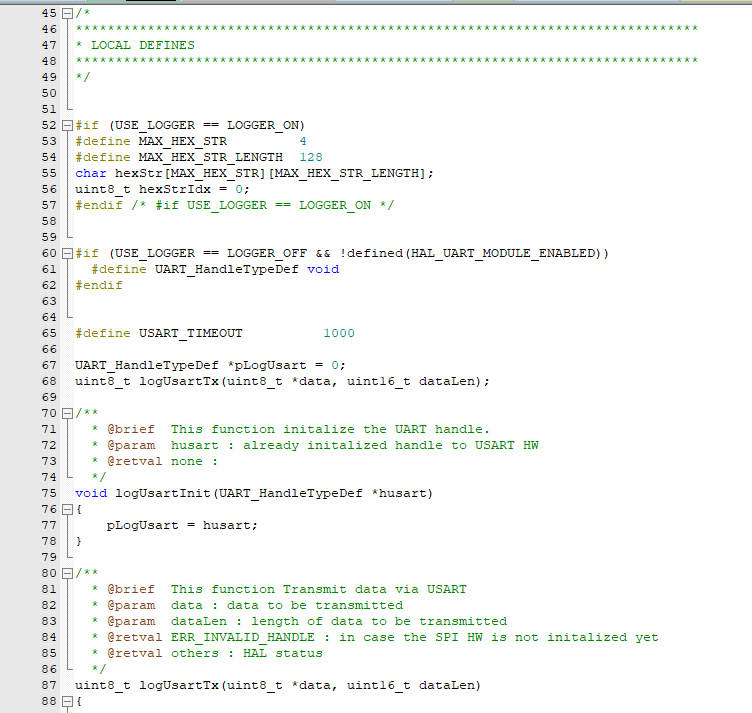

I am trying to get the demostration firmware to output some logs through UART or USART but was not able to do so.
Both USB cables are connected (micro and mini) and I used Putty to connect to the Mini USB interface (ST link USB port). I also put the board in the USB mode.
From the firmware side, I ensured that I recompiled and reflashed with
USE_LOGGER=1 -- was =2 originally in the example
I was not able to get anything out of the Putty connection, though all other functions are working ok.
Is there something I'm missing from my setup? or any physical jumpers that I need to change.
Attached are some of the logging code from the example firmware.
THanks in advance.
Ronald B.

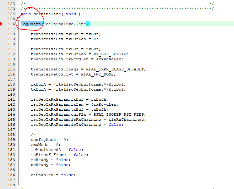

Hi Ronald,
Thanks for the guide on enabling logger for ST25R3916-DISCO. I was just comparing this to the example firmware for the NFC03 board which had logger enabled by default and was trying to replicate that.
If I understand it correctly there are already logger statements which dumps some status messages ie. ceInitialize in the existing DISCO firmware (as attached previously) so I'm not sure why you suggested that there are no useful messages.
The example firmware (and previously attached screenshot) was downloaded here
https://www.st.com/content/st_com/en/products/embedded-software/st25-nfc-rfid-software/stsw-st25r011.html, so I hope we are talking about the same firmware version/type.
Thanks again for replying.
Ronald B.
You're correct there are a bunch of log messages in the demo.
But maybe not enough to consistently monitor what the demo is doing (depending on your expectations).
Regards
ec.1
Thanks for the confirmation, I'll try out your suggestions and let you know later how I go.
ec.1
Works ok. However I have to add that in order to allow platformLog() to work we need to have the below in platform.h
#define platformLog(...) logUsart (__VA_ARGS__)
And perhaps add in some \r \n in the logging strings.
