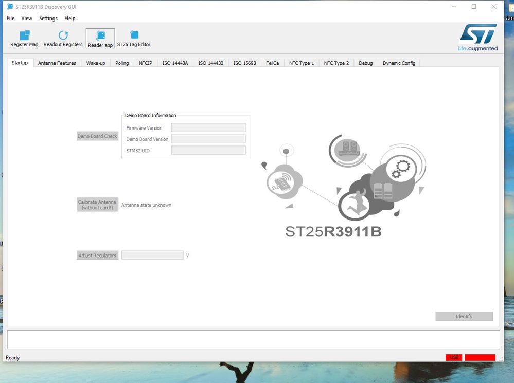

My problem solved and now I have a SPI communication by st25r3911b .
my new problems are :
1- External interrupt pin does not changed at all , I think when i close a mifare card in its antenna is should change , am I right ?
2- The ST25R3911B Discovery GUI program has no communication to it, I make a usb device for it and I am not sure in windows Device Manager what driver should add when ever I connect it to PC.
any help would be welcome

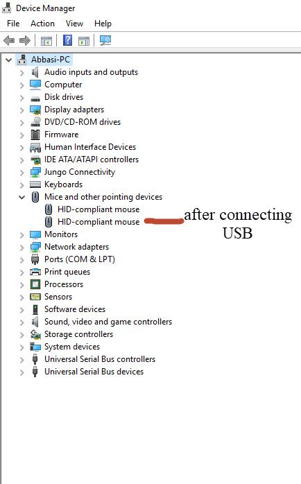

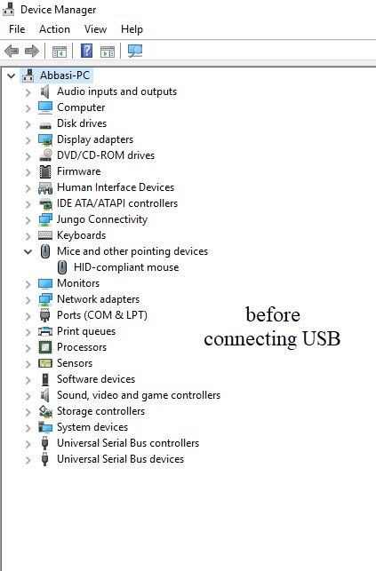

2.) When the ST25R3911B-DISCO board is connected you should be able to find a HID Device with HID\VID_0483&PID_3721&REV_0200&MI_00 .
The driver is delivered by Microsoft / Windows. No additional installation needed.

Thank you
about ST25R3911B Discovery GUI program , now I have hid device in my control panel and I am sure that driver is OK .
but still I have no communication in usb :
