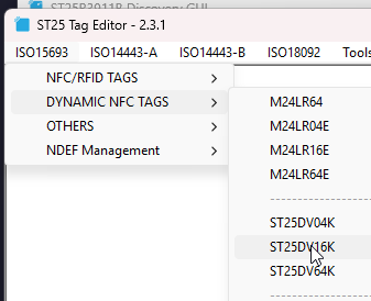

we use the ST25DV16KC and for development i use the ST25R3911B.
Problem is:

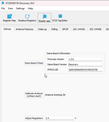

ST25R3911B connected via micro usb to the pc.
so far looks good
Pressing the TAG Editor Button

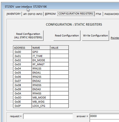

I just want to read the config:

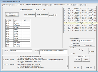

Pressing Button Read Configuration leads to this:
Same board same chip on my colleagues desk works.
1: What could be the issue?

The Tag Editor from the ST25R3911B-DISCO GUI is based on the CR95HF development software.
This software is no longer maintained and does not support ST25DVxxKC products.

the ST25 tag editor provided with ST25R3911B-DISCO GUI is to my knowledge not supporting the latest ST25DV*Kevolution of the products. Might be related to that, but not sure.
Not sure about your result at your colleague. You say everything the same (ST25DV tag, ST25R3911B board, ST25R3911B-DISCO GUI and ST25 Tag editor) - but result is different?

Result is that at leas at my colleagues desk reading is possible. Even though the gui is not compatible with the chip. What else tooling can i use for this NFC chip?
STSW-ST25PC001 should fully support ST25DV64KC. I didn't verify but it should also support the ST25R3911B-DISCO board as reader.
