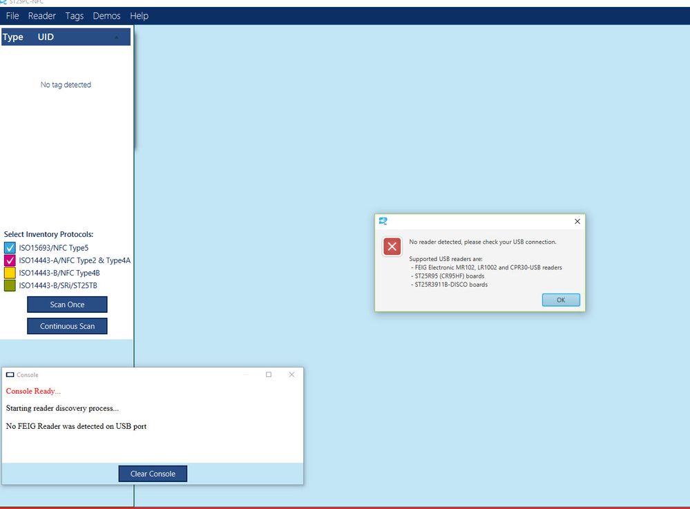

ST25R3911B SPI and ST25R3911B Discovery GUI has no commincatin
DAbba
Hi everybody
I am using st25r3911 in my own pcb and I still have a problem in the first step :
rfalInitialize() does not return ERR_NONE
in fact I see the MOSI and CLK and CS signal but there is not anything in MISO !!
pin28 in st25r3911b (mcu_clk) is ok so i think the chip is working .
23 REPLIES 23
Ulysses HERNIOSUS
Hi Dariush,
The GUI uses USB VID and PID to identify the boards. Please carefully review the USB descriptors.

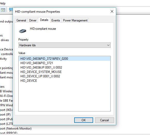

Hi Dariush,
with your changes I expect that the GUI has slightly changed its behavior - it should now detect a board. If not the please check VID and PID as they appear in the DeviceManager -> Hardware Ids.
Probably communication will then break. Getting a USB communication to work is somewhat tedious work. You will also need to review usbd_customhid.c inside STM32_USB_Device_Library.
It may also be necessary for you to get a USB tool to analyze on the PC side any differences in the USB descriptors which the PC sees.
Regards, Ulysses.

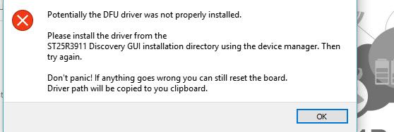

Thanks a lot for your attention .
I have done everything , but still I have problem :0690X000006CP9QQAW.jpg0690X000006CP9LQAW.jpg0690X000006CP9GQAW.jpg
could you please help me more to fix it ?
I have tried it by another PC also
Ulysses HERNIOSUS
Hi Dariush,
porting USB is effort. You will need to debug using various techniques (USB traces, debugger on the firmware, maybe debugger on the PC) the communication. What the firmware tries to send, what ends up on the PC, if the descriptors are similar/the same, etc.
I gave you all the tips I have.
Regards, Ulysses
