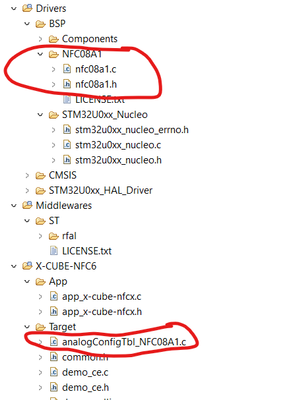

Hello BT,
    Thanks for your answer.
    I thought rfal lib is needed anyway to use st25r3916b driver, not only when using nfc081 ?
    My expectation is that I only need to remove that code encircled in the snapshot(meaning to uncheck only the nfc extension board support). Will look at it

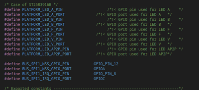

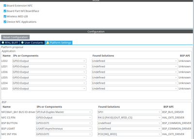

Using the same NFC08A1, I'm trying to generate code without the LED and UART COM dependencies, but it seems code generation fails on nfc_conf.h.
To be clear, I previously started from this config:
I cannot use this config, since other than the pins set under "Found Solutions", I have no free pins to assign to the LEDs. Moreover, I've defined my own logger, and I am using the Virtual COM from the BSP -> Human Machine Interface, which occupies USART2. Due to other config options, only USART1 is available, which is used for a different component.

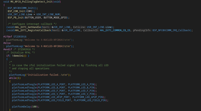

Leaving the pins as "undefined" causes CubeMX to generate code that does not compile, because the #define's for the various LEDs are left incomplete:
These are the pins used here:
Moreover, you can see the generated code uses BSP_COM_INIT(COM1), which is undefined, since no UART option is given to the X-CUBE-NFC6 config.

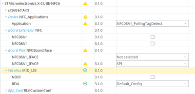

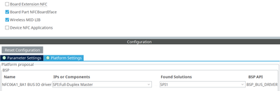

I've tried moving to a config that only uses SPI and RFAL (which I assume is enabled by the "Wireless MID LIB" option?):
But this causes the generation to fail for nfc_conf.h (fails silently, CubeMX itself reports no error):

After further testing, it seems the nfc_conf.h generation error happens every time all 4 options are NOT selected, either from software packages or in the configuration itself.
The same error as in the nfc_conf.h file is reported in the terminal when running the generation:
