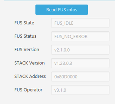

Following photo is what I captured at STM32cubeProgrammer after FUS and Wireless BLE Stack update
The board was running perfectly until recently, and it’s unclear why BLE initialization now fails.. (i never edited the code)
