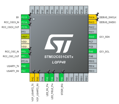

Step 1 – Connections
UM2890 - 4.1:
Pin definitions
• ST25R_SS_PIN / ST25R_SS_PORT - Not used because I have I2C.
• ST25R_INT_PIN / ST25R_INT_PORT - Yes
• ST25R_RESET_PIN / ST25R_RESET_PORT - Not used
• PLATFORM_LED_RX_PIN / PLATFORM_LED_RX_PORT - Yes
• PLATFORM_LED_FIELD_PIN / PLATFORM_LED_FIELD_PORT - Yes
I started with the following wiring:
ST25R3916B <--> STM32C031C6
       SDA  ->  PA10
       SCL  ->  PA9
       IRQ  ->  PB0 (ST25R_IRQ) (as GPIO_EXTI0)
STM32C031C6:
PC13 ->  B1
PA5  ->  LED_RX_Pin
PA6  ->  LED_FIELD_Pin
USART2 - for log

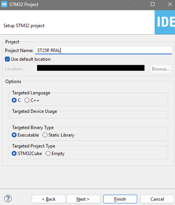

Step 2 – Project creation
I started with STM32CubeIDE:
  • File → New → STM32 Project
  • Selected my NUCLEO-C031C6 board
  • Created a new project:

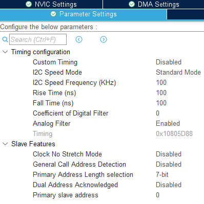

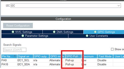

MCU configuration:
  • Connectivity → I²C → I²C mode with standard parameters:
  • GPIO settings for I²C: Enabled Pull-up resistors

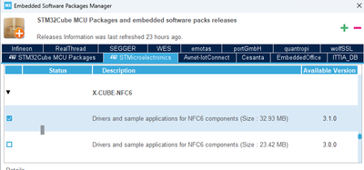

an STM32CubeMX pack is available for the ST25R3916(B): this is the X-CUBE-NFC6 pack.
Inside the documentation folder of this pack (in <yourhomedir>\STM32Cube\Repository\Packs\STMicroelectronics), the user manual provides step-by-step instructions to configure the MCU, set up the RFAL middleware, and select the appropriate communication interface. STM32CubeMX then generates a ready-to-use demo (polling demo or NDEF read demo).
It is recommended to base your development on the application generated by STM32CubeMX rather than manually integrating the RFAL from the standalone delivery. The standalone delivery is more suitable for non-ST MCUs, whereas the X-CUBE-NFC6 package is specifically designed for STM32 MCUs.
Rgds
BT

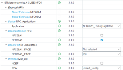

I have a custom board with the ST25R3916B chip.
And I don't understand whether I should choose "NFC_Applications" or "NFC_Boardface"?
Brian TIDAL
I suggest the following:
You will probably have to fake the LEDs that are used on the X-NUCLEO-NFC08A1 as your application uses it's own custom board with only RX and field leds.
Rgds
BT
