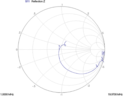

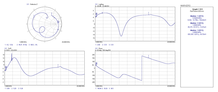

for my project I am using the X-Nucleo-NFC08A1 board. In addition, I am using an external antenna that I operate differentially. The antenna is connected to the board via an SMA connector. I know that I should also adjust the matching network to the antenna. For this, I wanted to use the ST25R Antenna Matching Tool, but I have a few problems determining the appropriate antenna parameters. I have also already read out the antenna via a VNA. :
The aim of the design is to match the antenna with the matching network to 50R at a frequency of 13.56 MHz, right?

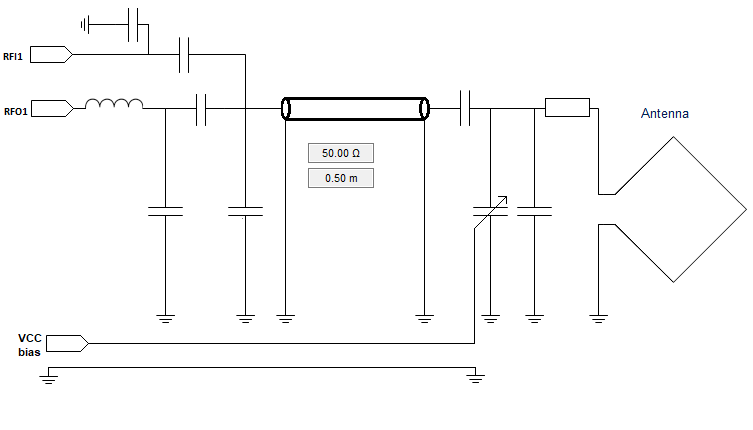

AAT principle is to change the resonance frequency of the antenna by changing the parallel cap connected to the antenna. With a cable (single ended with cable topology) in between this is not possible, because only the matching circuit for transforming from target matching impedance to 50Ohm is on the same PCB. The antenna is most likely on another PCB.
It would be possible if you have an additional line and VCC's (voltage controlled capacitors). You could then adjust the 50Ohm matching of the antenna itself (similar like on the differential matching).
You could also AC / DC couple the VCC controll line and NFC signal on the coax cable and extract it on the other side again. ( NFC Signal = AC, VCC bias voltage = DC). But the VCC signal must be filtered quite nicely i guess, otherwise you could get issues during FCC testing.

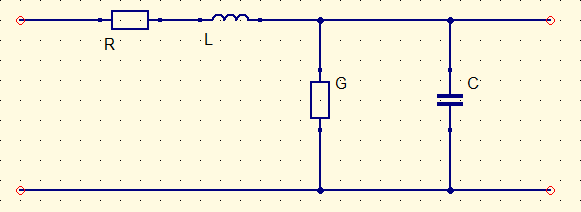

The Equivalent circuit of a coaxial cable looks like this:
Which I think is causing the un-symetrical wave shapes if also the shield is driven with the NFC signal.
I did not yet have time to run some simulations about that, but the signal line has R + L in series, where the shield does not. So my assumption is, if you have a differential signal on both of the lines, the impedance of both lines are different and the sinus signal looks different (not differential anymore) on each line.

Your antenna is quite de-tuned. The resonance frequency of the LC tank is too low.
I assume the parallel capacitor is too big.

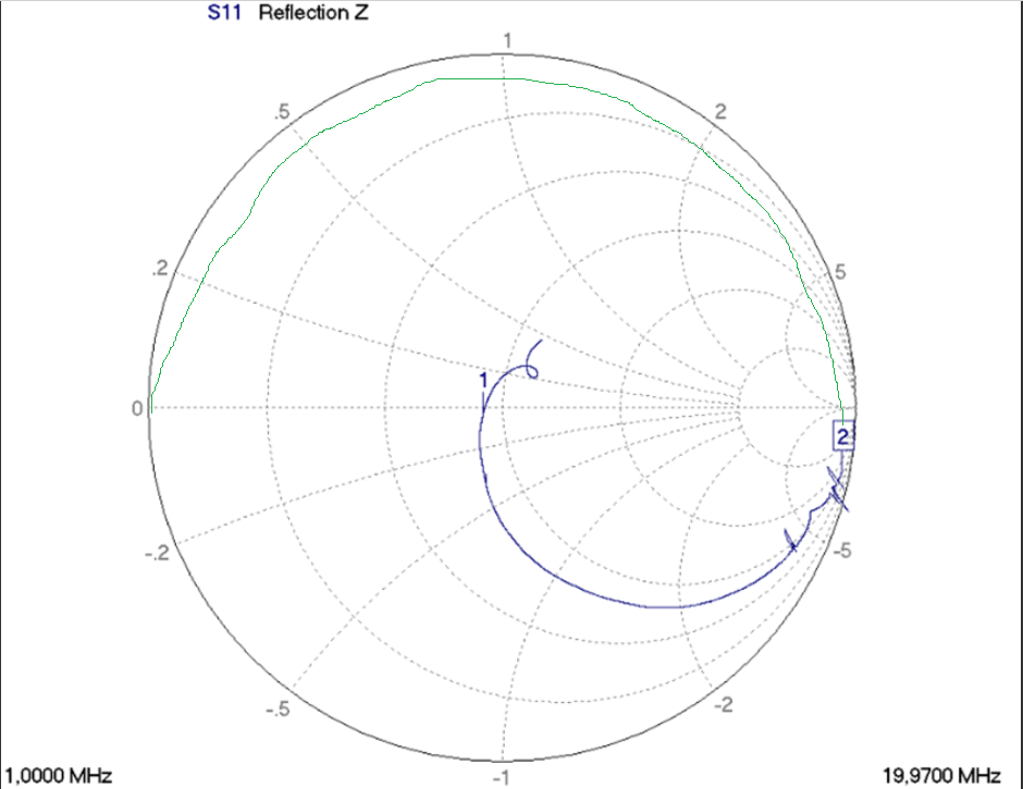

first of all thank you for you're answer. The picture shows the characteristics pf my antenna and its selfmade, so I dont have any data information. I followed the application notes and tried to use the tuning circuit calculator but the self-resonance-frequency is to low and I am not able to calculate the values of the other Devices. I tried to change some values to see what happens. The best version I got was this. Kepp in mind my antenna is connected to the circuit with long cable.
I changed C305 and C308 from 680pF to 330pF and added  an extra resistor with 22 Ohm. Am I on the right track or have I neglected something? I try to do some fine tuning to get a better impendace. I also want to ask if there is a problem with the extra resistor because I will lose some power on it ?
Best Regards
Additional with the help of the VNA i measured the antenna with the cable so the first picture of the post shows boath together.
Hello CT-55555,

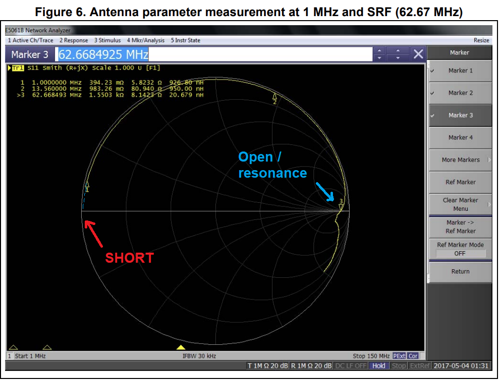

There is something strange with your VNA plot.
Typically for low frequencies the antenna is a short. So it starts in the left real axe origin of the smith chart. Its self resonance is then on the very right side of the real axe.
image.png  Your VNA plot looks different. Either you have an antenna with a very high Inductance value (the self resonance is already below your measurement range, or there is no DC path between the antenna ports - like a 50Ohm antenna.

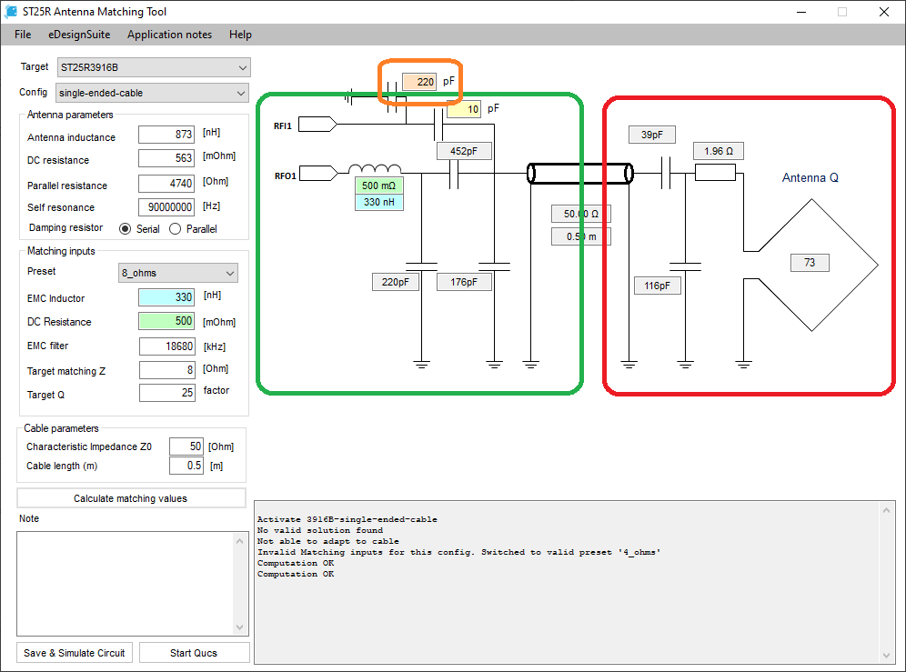

If your antenna already has a series and parallel capacitor on the PCB, then it is (most likely) already tuned to 50Ohm and this matching topology cannot be used.  You then have to change the matching topology to "single ended with cable". (most of the footprints can be re-used).
If this is the case you can use the following schematic:
Good news: you might not need to care about the red marked components since those are already defined by your antenna. You can start assembling the green marked components. Based on the Q-factor you might have to adapt the orange components based on the antenna design application note.
please let me know if this helped.

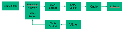

I think i need to explain the exact set up for the test.

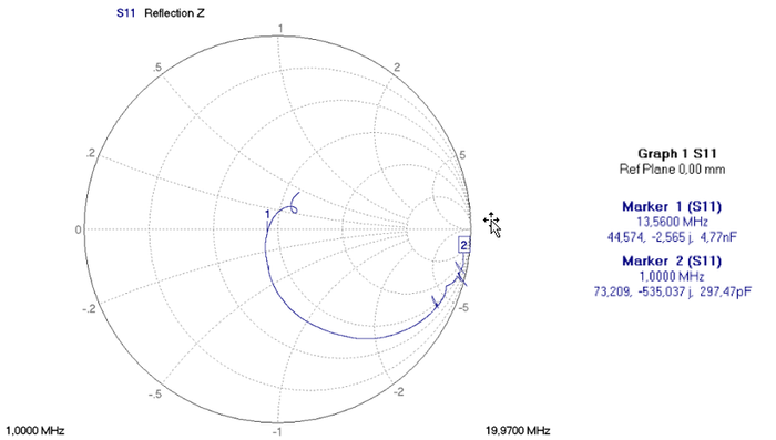

I modified the NFC08A1 board with two extra SMA sockets. One ist connected on RFO1 and RFO2 and the other one is connected to ANT1 and ANT2( Both came after the resistor of R300 and R302). Their is my first problem I dont know if their are significant misstakes maken by me because I use the shielding of the SMA socket for Data.
After changing some values on the matching circuit of the NFC08A1 i was able to change the impendace. Its more like try and error but I got some changes. This is the best I got. The smith chart shows the impendace of the antenna with the cable and the matching circuit.
Is this the right way or am I wrong? The differential antenna design has the big advantage that the transfered power is higher or is this false. I also want to keep the variable capacitors for the AAT.
Best Regards
