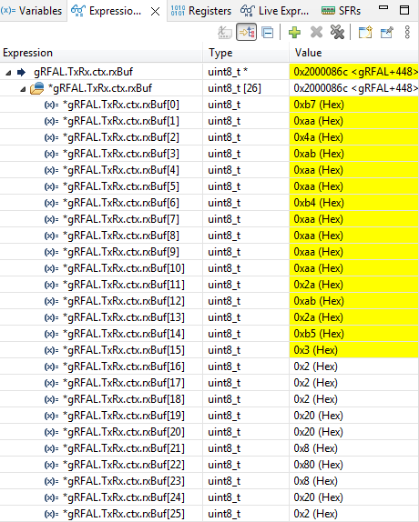

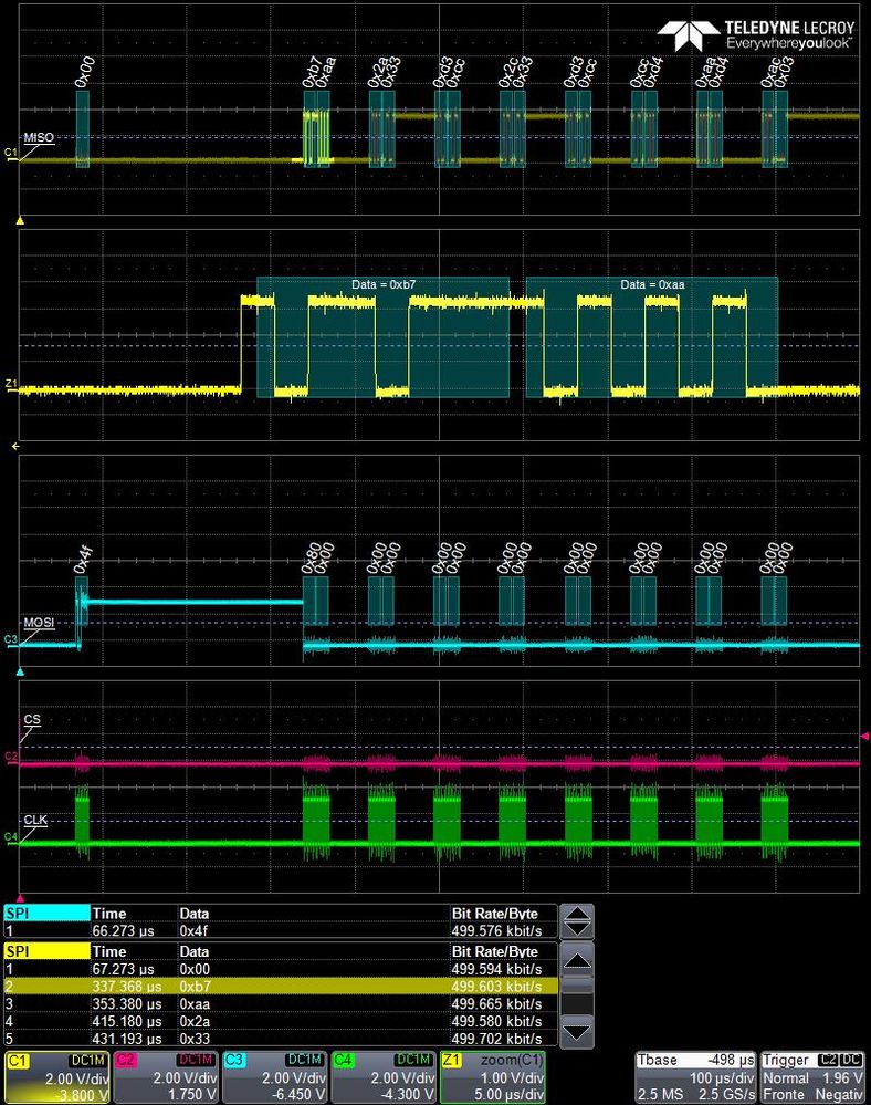

I both cases i triggered the scope to trace the byte transfer before st25r3916ReadFifo called by rfalTransceiveBlockingRx, immediately before rfalIso15693VICCDecode (where SOF is processed)
This is the scope trace with 3911B with SOF=0xb7 OK.
0693W00000bhDlTQAU.jpgand this is the buffer (same byte sequence decoded by the scope OK)

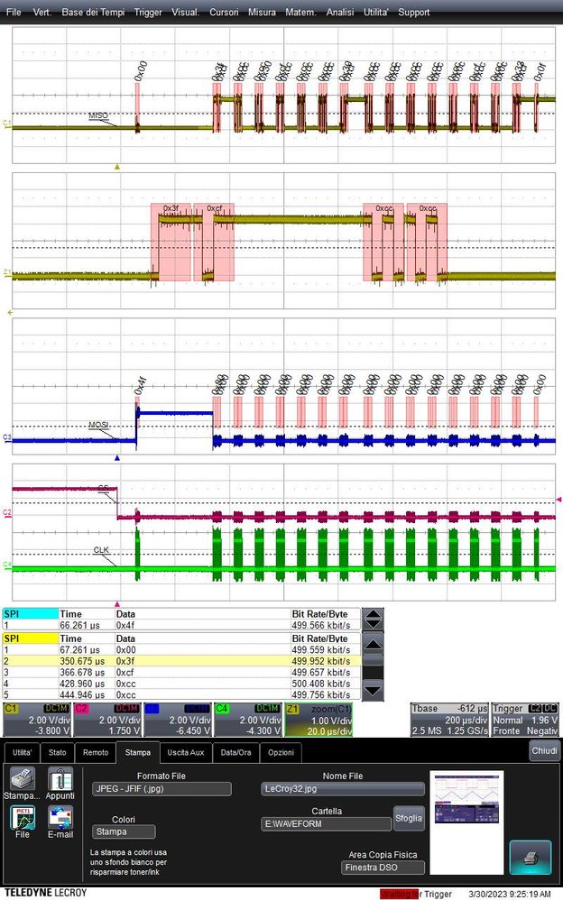

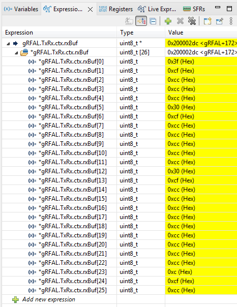

0693W00000bhDmlQAE.pngThis is the scope trace with 3916B with SOF=0x3f FAIL
0693W00000bhDmqQAE.jpgand this is the buffer (same byte sequence decoded by the scope FAIL)
0693W00000bhDn5QAE.pngYou can observe the the number of bytes written when reading from the fifo is higher than the 3911B case.

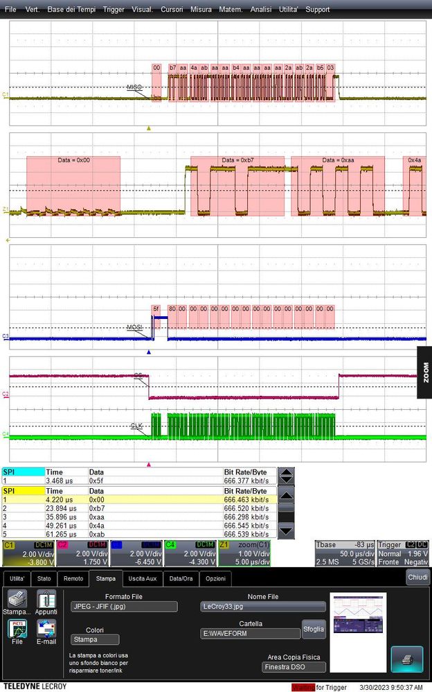

Just to have a reference 3916B when it is working, i did the same trace with a standard read command rfalNfcvPollerReadSingleBlock from block address 2. I called the function just before the point where the custom read fails.
The buffer start with the right SOF
0693W00000bhDoXQAU.jpgAny suggestion?

Looking at the received pattern it seems not a simple shift or damaged SOF:
3f      cf      cc      cc      cc      30      cf
11111100111100110011001100110011001100110000110011110011
The sequence should have a SOF symbol of 11101 followed by only 01 or 10 symbols until EOF.
Did you by mistake set the two subcarriers request flag?
