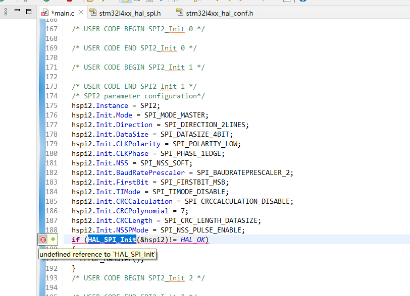

Here is my code to add the SPI function. But undefined reference to 'HAL_SPl_Init'.

�?��?空隙MX_SPI2_Init(空隙)
#include "app_nfc7.h"
/* USER CODE END Includes */
/* USER CODE BEGIN PTD */
/* USER CODE END PTD */
/* USER CODE BEGIN PD */
/* USER CODE END PD */
/* USER CODE BEGIN PM */
/* 用户代�?结�?� 下�?� */
SPI_HandleTypeDef HSPI2;
static void MX_SPI2_Init(void);
/* USER CODE BEGIN PFP */
/* USER CODE END PFP */
/* USER CODE BEGIN 0 */
/* USER CODE END 0 */
 * @brief The application entry point.
 * @retval int
int main(void)
 /* USER CODE BEGIN 1 */
 /* USER CODE END 1 */
 /* Reset of all peripherals,f Initializes the Flash interface and the Systick. */
 HAL_Init();
 #define HAL_SPI_MODULE_ENABLED
 /* USER CODE BEGIN Init */
 /* USER CODE END Init */
 SystemClock_Config();
 /* USER CODE BEGIN SysInit */
 /* USER CODE END SysInit */
 MX_GPIO_Init();
 MX_SPI2_Init();
 MX_NFC7_Init();
 /* USER CODE BEGIN 2 */
 /* USER CODE END 2 */
 /* Infinite loop */
 /* USER CODE BEGIN WHILE */
 while (1)
  /* USER CODE END WHILE */
 MX_NFC7_Process();
  /* USER CODE BEGIN 3 */
 /* USER CODE END 3 */
 * @retval None
void SystemClock_Config(void)
 if (HAL_PWREx_ControlVoltageScaling(PWR_REGULATOR_VOLTAGE_SCALE1) != HAL_OK)
  Error_Handler();
 RCC_OscInitStruct.OscillatorType = RCC_OSCILLATORTYPE_HSI;
 RCC_OscInitStruct.PLL.PLLSource = RCC_PLLSOURCE_HSI;
 RCC_OscInitStruct.PLL.PLLM = 1;
 RCC_OscInitStruct.PLL.PLLN = 10;
 RCC_OscInitStruct.PLL.PLLP = RCC_PLLP_DIV7;
 RCC_OscInitStruct.PLL.PLLQ = RCC_PLLQ_DIV2;
 RCC_OscInitStruct.PLL.PLLR = RCC_PLLR_DIV2;
  Error_Handler();
 RCC_ClkInitStruct.APB1CLKDivider = RCC_HCLK_DIV1;
 RCC_ClkInitStruct.APB2CLKDivider = RCC_HCLK_DIV1;
 if (HAL_RCC_ClockConfig(&RCC_ClkInitStruct, FLASH_LATENCY_4) != HAL_OK)
  Error_Handler();
 * @brief SPI2 Initialization Function
 * @param None
 * @retval None
 /* USER CODE BEGIN SPI2_Init 0 */
 /* USER CODE END SPI2_Init 0 */
 /* USER CODE BEGIN SPI2_Init 1 */
 /* USER CODE END SPI2_Init 1 */
 /* SPI2 parameter configuration*/
 hspi2.Instance = SPI2;
 hspi2.Init.Mode = SPI_MODE_MASTER;
 hspi2.Init.Direction = SPI_DIRECTION_2LINES;
 hspi2.Init.DataSize = SPI_DATASIZE_4BIT;
 hspi2.Init.CLKPolarity = SPI_POLARITY_LOW;
 hspi2.Init.CLKPhase = SPI_PHASE_1EDGE;
 hspi2.Init.NSS = SPI_NSS_SOFT;
 hspi2.Init.BaudRatePrescaler = SPI_BAUDRATEPRESCALER_2;
 hspi2.Init.FirstBit = SPI_FIRSTBIT_MSB;
 hspi2.Init.TIMode = SPI_TIMODE_DISABLE;
 hspi2.Init.CRCCalculation = SPI_CRCCALCULATION_DISABLE;
 hspi2.Init.CRCPolynomial = 7;
 hspi2.Init.CRCLength = SPI_CRC_LENGTH_DATASIZE;
 hspi2.Init.NSSPMode = SPI_NSS_PULSE_ENABLE;
 if (HAL_SPI_Init(&hspi2)!= HAL_OK)
  Error_Handler();
 /* USER CODE BEGIN SPI2_Init 2 */
/* 用户代�?结�?� SPI2_Init 2 */

Obviously, stm32l4xx_hal_spi.c is not included in your project. I suggest to check.

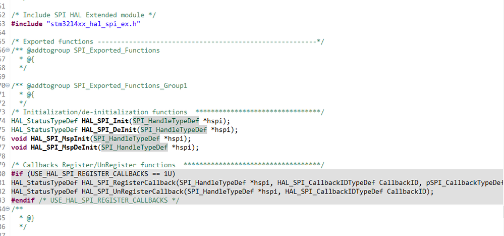

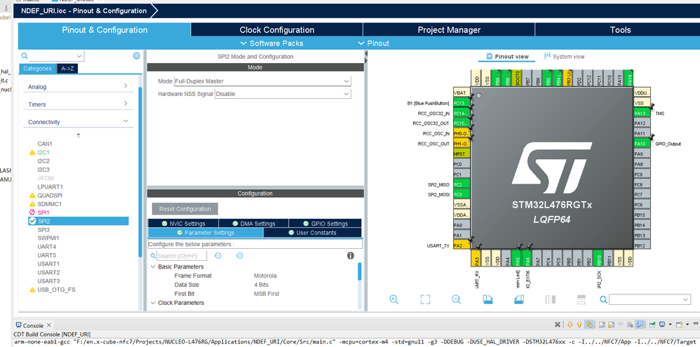

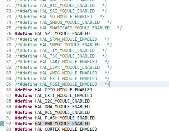

if I am not wrong, X-CUBE-NFC7 demos are delivered with an STM32CubeMX project file (.ioc file). It is not recommended to modify generated code but rather to use STM32CubeMX to add and configure peripherals. When regenerating the code, STM32CubeMX automatically updates the IDE project file (such as adding stm32l4xx_hal_spi.c and stm32l4xx_hal_spi_ex.c in the project file and defining HAL_SPI_MODULE_ENABLED inside stm32l4xx_hal_conf.h).
Make sure to have #define HAL_SPI_MODULE_ENABLED inside stm32l4xx_hal_conf.h and make sure to have stm32l4xx_hal_spi.c and stm32l4xx_hal_spi_ex.c in your project.

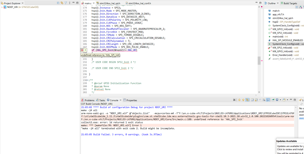

I have checked the relevant content and found no problem.  stm32l4xx_hal_spi.c and stm32l4xx_hal_spi_ex.c in my project and able to jump correctly.I don't know what the problem is.0693W00000bhS90QAE.png0693W00000bhS95QAE.png0693W00000bhS8bQAE.png

what is the exact output of the compiler/linker?

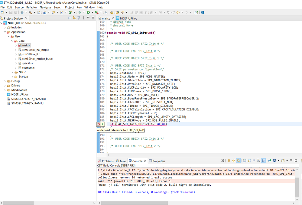

Here is the output of the compiler/linker,my code is from STM32 cubemx and make sure  have stm32l4xx_hal_spi.c what should I do?0693W00000bhUq6QAE.png
Brian TIDAL
I believe there was an issue to regenerate the project while it was already opened/locked inside STM32CubeIDE. I would suggest to clean the project, close it, remove it from the workspace and re-import it.

I also think I have problem, but I don't know what should I do? 0693W00000bhXVfQAM.png0693W00000bhXVpQAM.png
Brian TIDAL

I check my project ​according to your advice,and run the codes successfully. Thanks!
