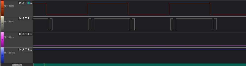

前段时间使用ST25R3911B成功实现透明模式的通信,很遗憾的是ST25R3911B不支持负载调制,从而选择ST25R3916B作为替代。
目前已经将ST25R3911B透明模式的代码移植到ST25R3916B的芯片上,使用的是OOK的调制方式,移植之后发送数据的已调信号是正常的,接收的信号通过MISO引脚输出异常,如附件图片所示。MOSI引脚负责调制载波,理论上MISO输出的脉宽应该与基带信号一致,这点在ST25R3911B上可以验证。
问题1:ST25R3916B在透明模式的接收配置方面,相比ST25R3911B,是否需要更多的配置,避免出现附件里面的问题?
问题2:ST25R3916B是否支持在透明模式中,使用负载调制的方式发送数据?

补充一点,在进入透明模式之前,同时使能发送和接收,意味着ST25R3916B在线圈上发送的数据,同时也可以被接收。这样可以简单测试芯片数据收发的情况,上面图片调制的脉宽是100us。

I think you are looking at a difference in receivers: 3916 has a correlating receiver (unless dis_corr=1) and you will not see all the subcarrier pulse but a 1 while the chip detects the subcarrier.
Please also compare:
BR, Ulysses

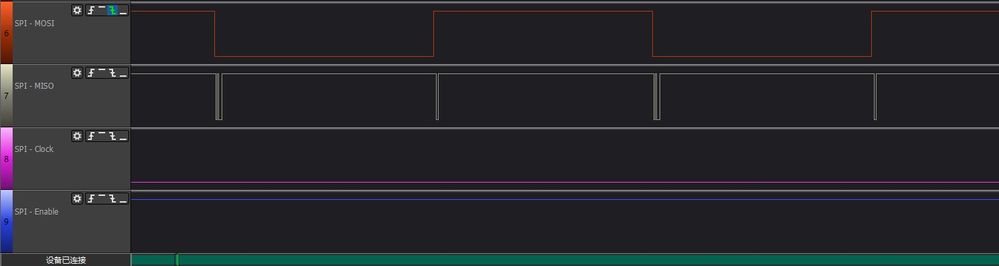

感谢您的快速回复,如你所说,当我配置dis_corr=1时,透明模式的MISO输出波形确实有变化,但仍然不是预期的效果(如图片),我将研究相关器的配置。
另外,我只是需要将主机(ST25R3911B)发送的MOSI波形可以透明地传输到从机(ST25R3916B)的MISO,如果可以的话,请指出如何进行这样的配置。

Thank you for your quick reply. As you said, when I configured dis_corr=1, the MISO output waveform of transparent mode did change, but it was still not the expected effect (as shown in the picture). I will study the configuration of correlator.
Also, I just need the MOSI waveform sent by the host (ST25R3911B) to be transparently transmitted to the MISO of the slave (ST25R3916B), if possible, please indicate how to do this configuration.

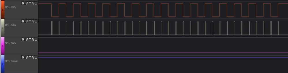

补充一点,当配置dis_corr=1时,如果把调制的脉宽改为10us(即MOSI),MISO的输出并不是预期的。

In addition, MISO output is not expected if the modulated pulse width is changed to 10us (i.e. MOSI) when dis_corr=1 is configured.
I think this picture should give you a better look at the details of the waveform.

Hi Jack_Chen,
I may have been mixing ST25R3916 and ST25R3916B. As ST25R3916B has only the correlating receiver not sure if dis_corr=1 still works. What was your setting of om and targ bits?
With targ=0,om!=0 you should get reader mode operation.
With om=0,targ=0 you would be selecting an AP2P mode. And to your previous question: targ=1,om=1 would be passive target mode. In both modes MISO will have NFC-A demod, and IRQ NFC-F demod.
Especially for reader mode you should also set the all the analog receiver settings (low pass, high pass, etc.)
BR, Ulysses
