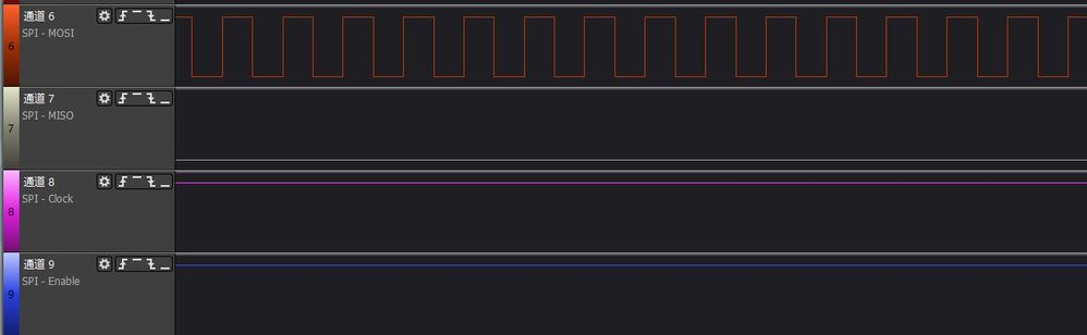

从机使用的开发板是X-NUCLEO-NFC08A1(ST25R3916B),计划使用板上的线圈在透明模式中进行负载调制,我认为和lm_ext和lm_ext_pol的设置没有关系,与EXT_LM引脚也是不相关的。
主机和从机都工作在透明模式,双方都使能tx和rx,主机/PCD配置targ=0,从机/PICC配置targ=1。目前从机并没有发送实际的数据,只是在MOSI引脚上输入一个方波(如图,脉宽10us),简单验证主机是否可以正常接收。预期是主机可以收到与从机相同的方波,目前使用逻辑分析仪在主机的MISO上没有观察到任何输出。
The development board used by the slave is X-NUCLEO-NFC08A1 (ST25R3916B), and it is planned to use the coils on the board for load modulation in transparent mode, which I think has nothing to do with the setup of lm_ext and lm_ext_pol, and is also unrelated to the EXT_LM pins.
Both host and slave work in transparent mode, with tx and rx enabled on both sides, targ=0 for host /PCD and targ=1 for slave /PICC. At present, the slave does not send actual data, just input a square wave (as shown in the figure, pulse width 10us) on the MOSI pin to simply verify whether the host can receive normally. The expectation is that the host can receive the same square wave as the slave, and no output is currently observed on the MISO of the host using the logic analyzer.
Best Regards

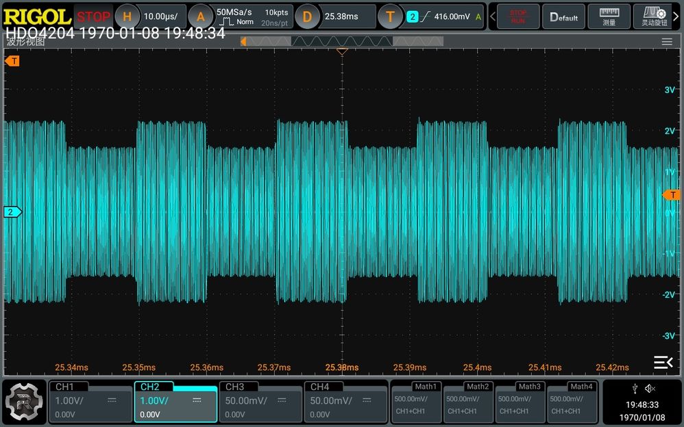

我想我已经可以实现PICC透明模式的负载调制了,实现的方式与你的说法有所不同,配置targ=0,使用的是RFO1和RFO2的驱动电阻进行调制,这个与EXT_LM并不相关。
如图所看到的,基带信号的脉宽是10us,看到调制后的波形类似于ASK调制后的波形。放大信号波形,也没有看到关于848KHz负载波的信号。
最后,还是非常感谢你的回复对我的启发。
I think I have been able to achieve PICC transparent mode load modulation, the way to achieve it is different from your statement, the configuration targ=0, using RFO1 and RFO2 driver resistance modulation, this is not related to EXT_LM.
As can be seen in the figure, the pulse width of the baseband signal is 10us, and the waveform after seeing modulation is similar to that after ASK modulation. Amplification of the signal waveform, also did not see the 848KHz negative carrier signal.
Finally, thank you very much for inspiring me with your reply.
Best Regards
2024-01-09 11:54 PM
was never claiming that with targ=0 that you would have something on EXT_LM. Only with targ=1 while doing load modulation on the PICC.
Good that it works for you but just again the warning: targ=0 transparent receiver should not give a demodulated signal on MISO but a correlated signal.
BR, Ulysses
