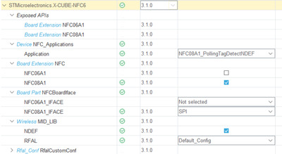

make sure to properly configure the components:
and then:
This should generate the NDEF application.

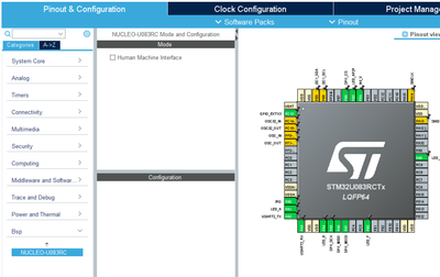

Hello BT,
    I can generate the needed code in MX but when I import it in cubeIDE there are compilation issues. APIs are not the same even though are used one from another, for example:
void MX_NFC8_PollingTagDetectNDEF_Init(void)
   BSP_NFC0XCOMM_Init();
   BSP_COM_Init(COM1);
but declaration is:
#if (USE_BSP_COM_FEATURE > 0)
int32_t  BSP_COM_Init(COM_TypeDef COM, COM_InitTypeDef *COM_Init);
int32_t  BSP_COM_DeInit(COM_TypeDef COM);
so is not easy to integrate the generated code from MX
Best regards,
          Mihai

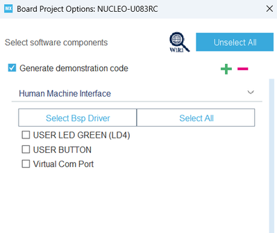

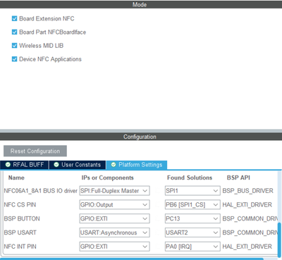

Hello BT,
    Yes, you are right SPI is by default use, for I2C hardware changes to the expansion board are needed.
    I knew that but somehow I generate it by mistake for I2C in the project I was referring.
   For the picture above I  have "No solution" for HAL_EXTI_DRIVER and BSP_COMMON_DRIVER(for USART).
   Am i missing some components to check in for CubeMX ?
Thanks,
      Mihai
like this:
