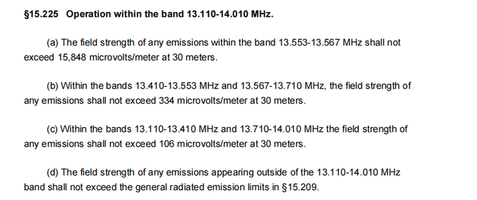

Hi ST members !
Did ST25R95 tested against FCC Rule Part(s) 15?If yes ,can you share FCC certification link ,thaks!
Usually ,ST25R95 transmit power will under this limit?
Brian TIDAL
the X-NUCLEO-NFC03A1 featuring the ST25R95 complies with Part 15 of the FCC Rules. See section 6.1 FCC Compliance Statement in UM2479 Getting started with X-NUCLEO-NFC03A1 NFC card reader board based on ST25R95 for STM32 Nucleo and related FCC ID: YCPNFC03A1.
Rgds
BT
