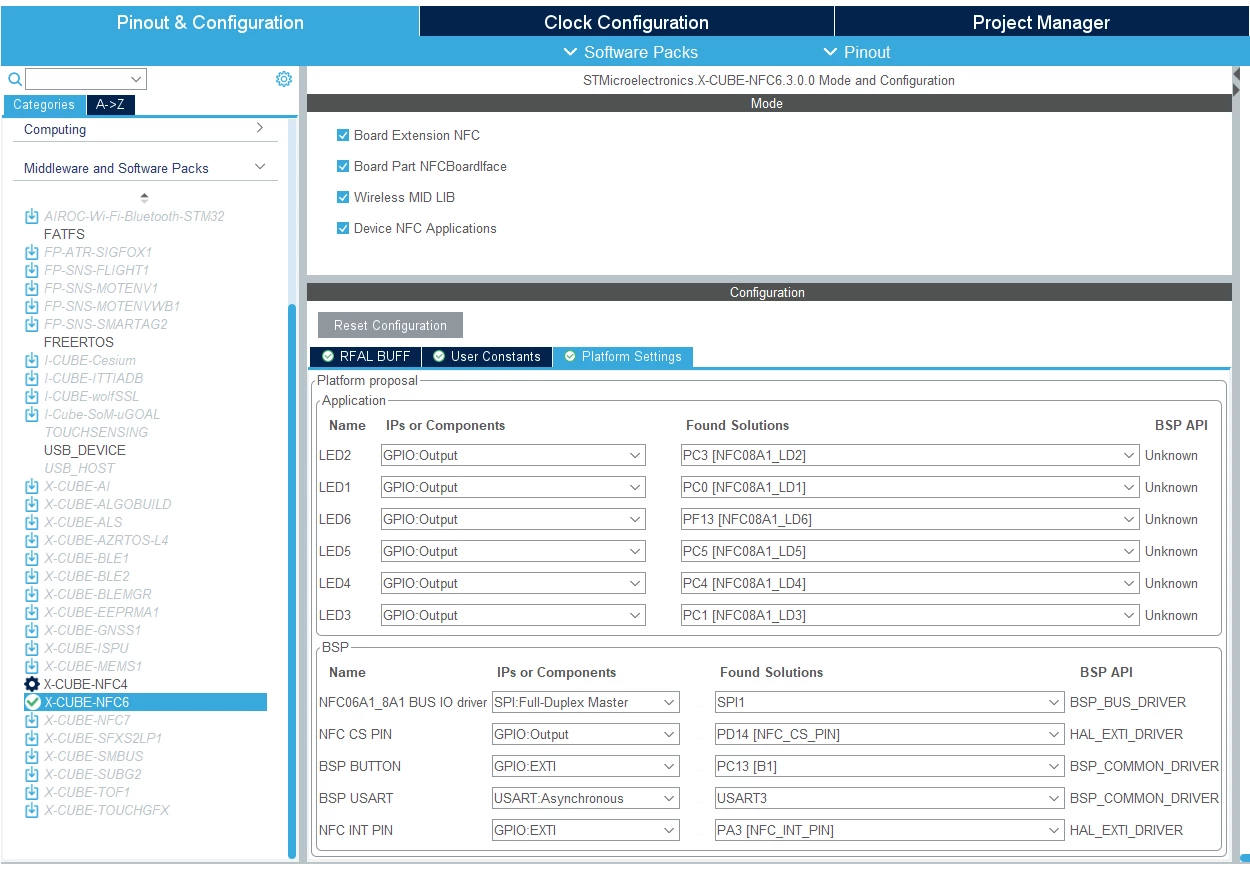

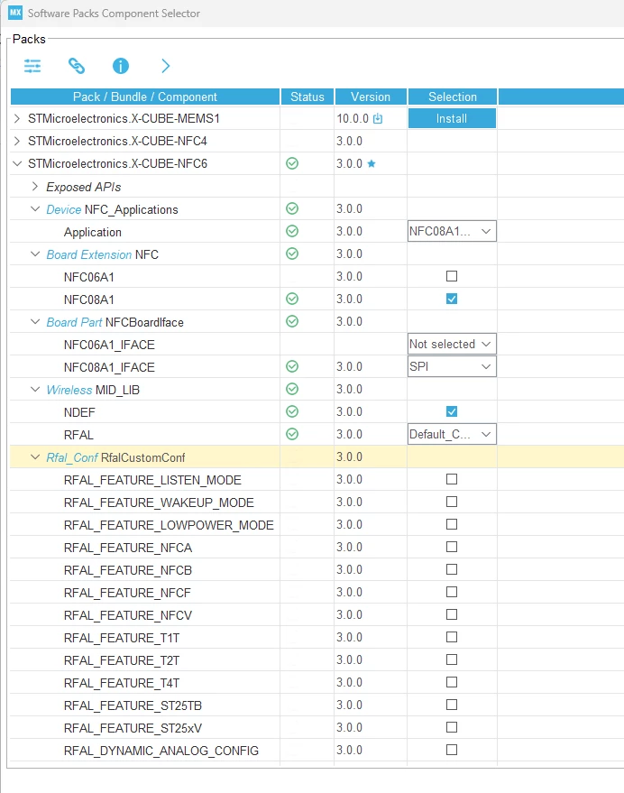

Hi, i need help with the integration between NUCLEO-L4T5ZI and X-NUCLEO-NFC08A1 board.
What I tried is:
  1. Create a project using STM32CubeIDE.
  2. Choose X-CUBE-NFC in the Middleware and Software Packs and update the configuration.

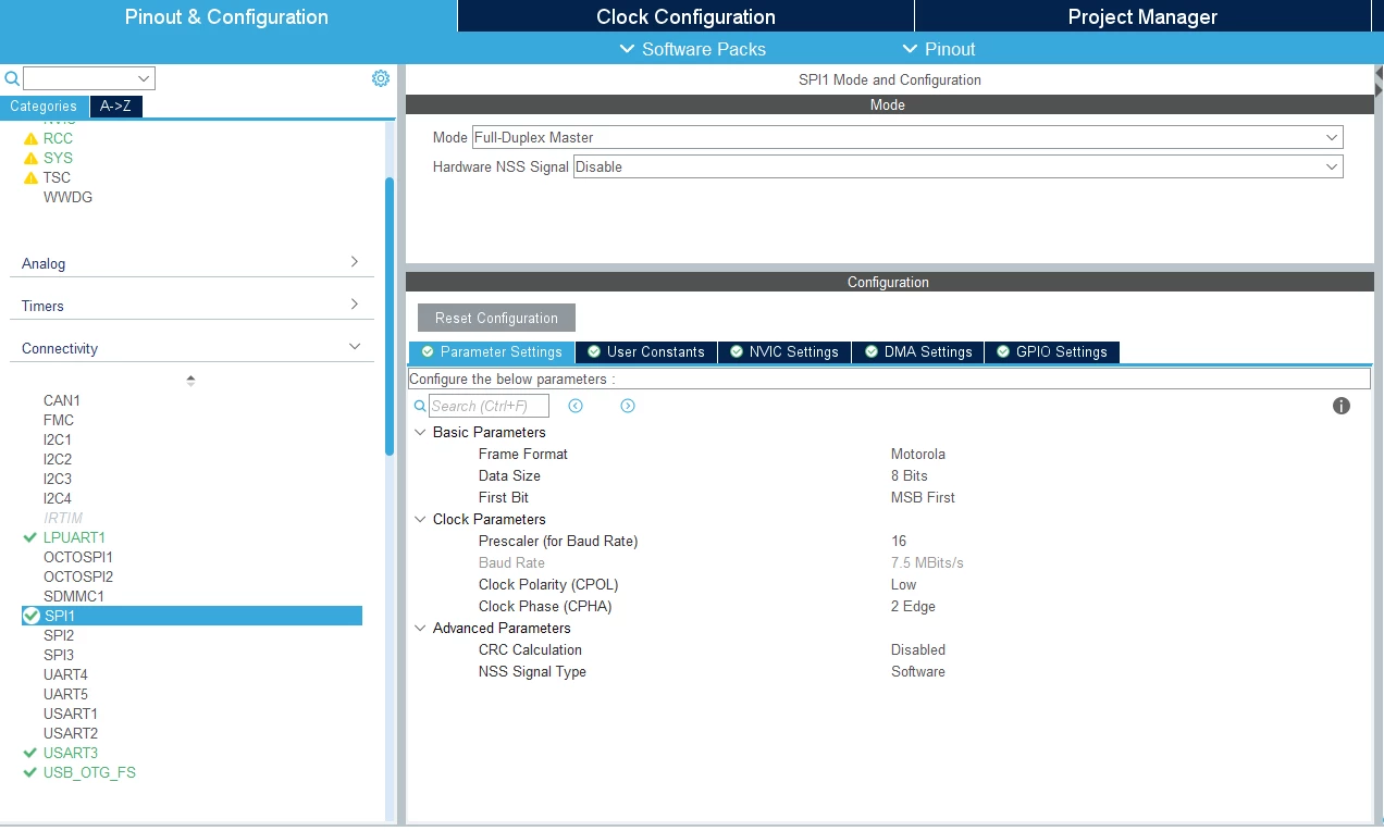

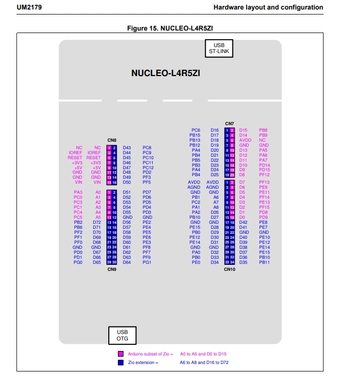

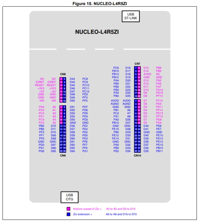

    2. Update the PIN assignment
      CheeSiong_0-1700698878358.pngCheeSiong_1-1700699017488.pngCheeSiong_2-1700699133855.png
    3.  Use the automatic code generation feature to generate the code
      1. the attachment is the .ioc file with the above settings Google Drive link

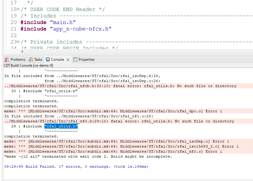

    4. I found that after the code generation didnt generate the "rfal_utils.h" file, the X-CUBE-NFC is version 3.0.0 downloaded in the STM32CubeIDE MCU Embedded Software Packages Manager. So I copy the "rfal_utils.h" file from the ST X-CUBE-NFC6 download linkCheeSiong_3-1700699734597.png
    5.  After copying the "rfal_utils.h" to the project, the project can be built successfully but the demo project not running successfully on the hardware.
    6. I probed the MISO/MOSI PIN with an oscilloscope and found no signal.
  3. This is my project file -> Google Drive link
    Can anyone guide me? I'm a STM32 Beginner and this is my first time using the STM32 dev environment.

Hi @CheeSiong
the rfal_utils.h issue has been already identified internally. A fix will be available in the next release of the X-CUBE-NFC6 package (likely in few days).
I had a look to the project file. The EXTI Line 3 interrupt has not been enabled:
This is the interrupt used by the ST25R3916B device to signal events. Make sure to enable this interrupt otherwise the system will stay stuck at initialization stage.
Also I would suggest to enable the ST25R_SELFTEST switch in your project to debug the initialization stage and to run the st25r3916Initialize step by step if you still have some issues.

Thanks, @Brian TIDAL , it works now!

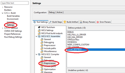

Regarding your question "By the way, may I ask how to enable the ST25R_SELFTEST?": open the project properties:
and add the ST25R_SELFTEST in the Define symbols.
Rgds
BT
