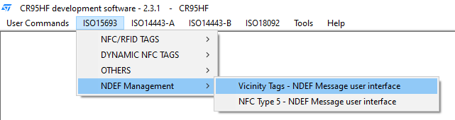

I was playing around with the discovery board for my internship, to get to know NFC. I have installed the CR95HF Development Software that goes along with the M24LR04E Discovery Kit.
0690X000009jCDhQAM.pngWhen playing around with the Vicinity Tags - NDEF Message user interface, I could read and write away NDEF messages to the M24LR04E Discovery Board.

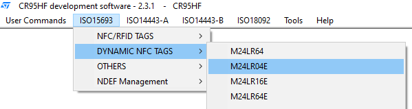

0690X000009jCE1QAM.pngAfter that I opened this program: the ISO15693 User Interface M24LR04E. Here I started playing around (my fault, I didnt know really what I was doing). I think I may have overwritten data here that wrecked the functionality of the M24LR04E Discovery Board, or locked something with the sector password stuff. Honestly Im not sure what I did.
Is there any way to fix this/reset the M24LR04E Discovery Board to starting conditions? I cannot seem to fix this or find a way to reset the board.

You can restore the NDEF in the following way:
In NFC Type 5 - NDEF message user interface,
  • use READ WRITE CC FILE and write the following content: E1 40 40 01
  • use PREPARE NDEF and add a Text (e.g. FIELD ON)
  • use WRITE NDEF and write the text record to the tag
The M24LR-discovery should now display FIELD ON

You can check the content of your memory's tag using the CR95HF GUI:
  • go in ISO15693->DYNAMIC NFC TAGS->M24LR04E
  • then in the User Mode tab, select addresses from 000 to 00F and click on "Read Single Block"
You should now see the content of your tag's memory.
CCFile is the first 4 bytes of the memory at address 00. Then comes the NDEF file, terminated by "FE"
You can restore the content of the tag's memory by two ways: using the ISO15693->DYNAMIC NFC TAGS->M24LR04E interface and directly write correct values in the memory, or use the ISO15693->NDEF Management->Vincinity Tags - NDEF Message user interface to directly write CCfiel and NDEF message.
If using the ISO15693->DYNAMIC NFC TAGS->M24LR04E interface, you will need to send 'Write Single Block" commands with correct data and correct addresses in memory.
