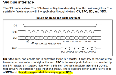

What is the SPI mode of the gyroscope sensor I3G4250D?
duoc_ngo261
I use the KIT STM32F411 Discovery
When I choose:
SPI CPOL: Low
SPI CPHA: 1 Edge
It works
But when I choose:
SPI CPOL: High
SPI CPHA: 2 Edge
It does not work
Could you explain why? Thank you!

> SPI CPOL: High
> SPI CPHA: 2 Edge
These are the correct settings. If it doesn't work, there's probably a bug in your code.
Ensure SPI peripheral is active before you assert CS. Send a dummy transfer without CS active in order to ensure this.

> hspi1.Init.CLKPolarity = SPI_POLARITY_LOW;
> hspi1.Init.CLKPhase = SPI_PHASE_1EDGE;
These are incorrect, as explained above.

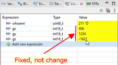

I recorded my screen and send you my project in the attachment.

What does L3GD20_Read_WHOAMI return?
--> It returns 211
When I use
 > hspi1.Init.CLKPolarity = SPI_POLARITY_HIGH;
> hspi1.Init.CLKPhase = SPI_PHASE_2EDGE;
The sensor returns only 1 time (then the sensor data does not change anymore)
Do you know the reason why?
Thank you
