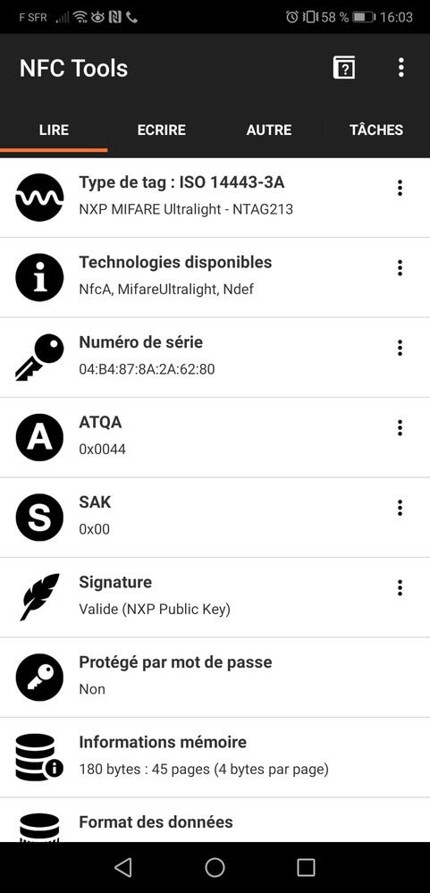

Regarding the T2T issue ;
According to the NFC tool android application, it's an NXP MIFARE Ultralight- NTAG 213

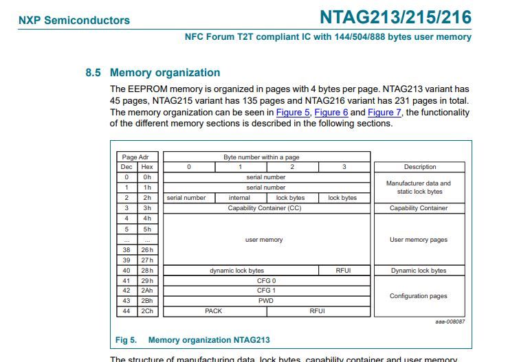

But i don't understand how you manage to find the Control lock TLV on adress 16, because when I study the data sheet , it's only for user memory :
https://www.nxp.com/docs/en/data-sheet/NTAG213_215_216.pdf

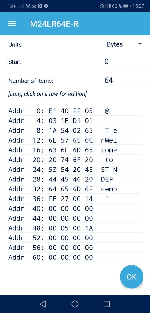

Regarding the M24LR (T5T)

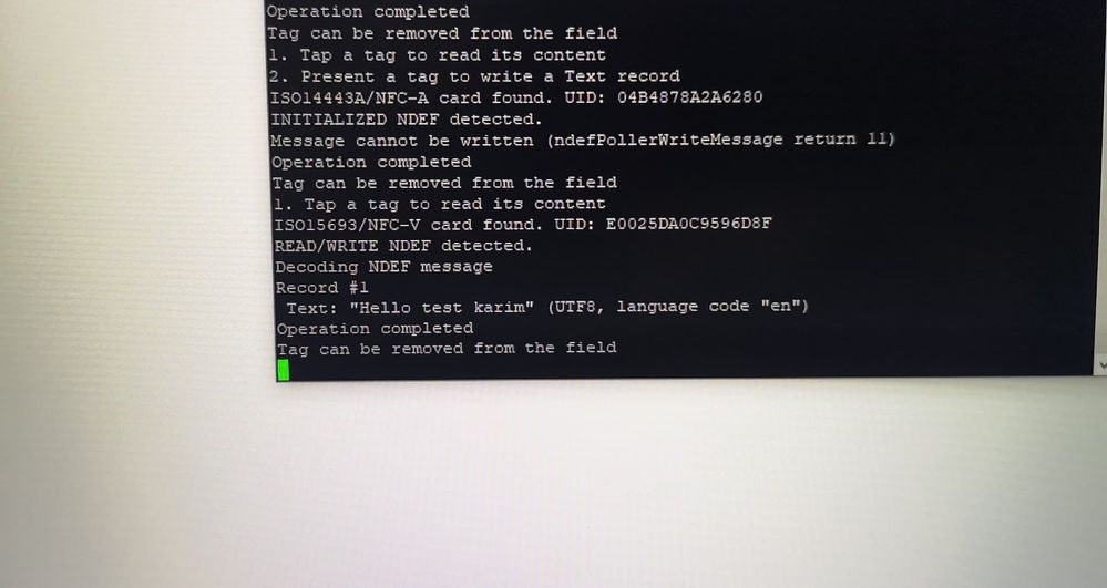

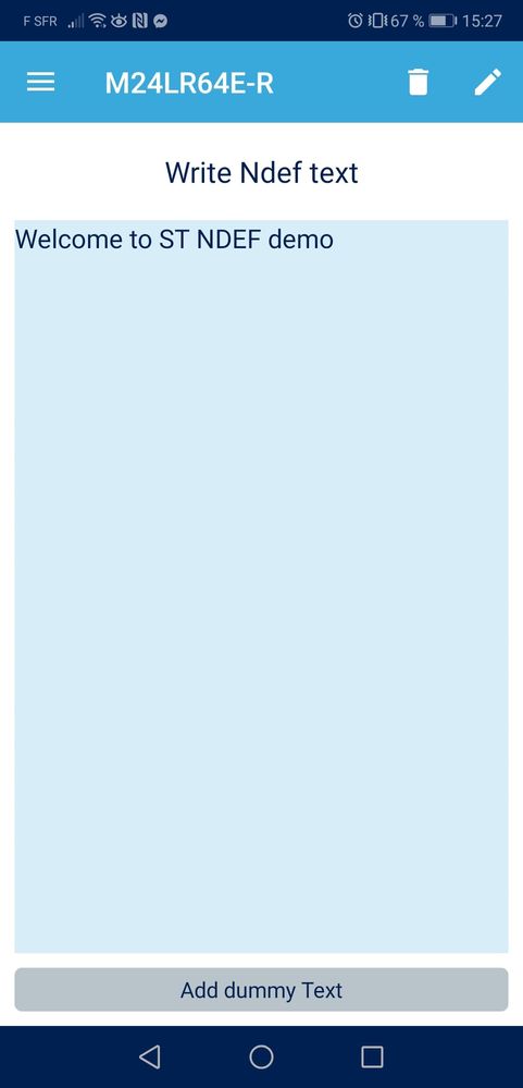

After formating from X PACKAGE application, and write through X PACKAGE application too, i can read on the android application :
And the memory :

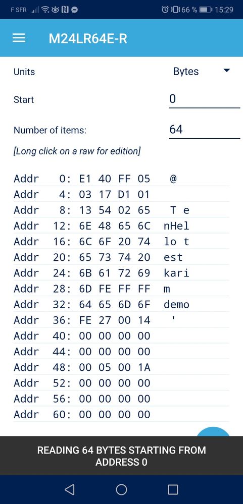

Then i tried to modify the message and read back the memory again :
And when I try to read it back on the X PACKAGE application, it's working fine :
But, i am now trying to understand why the adress n°05; 06; 07 has changed when i modified the message.

Hi Karim,
for T2T: as per the NFC Forum Technical Specification T2T v1.0, different TLV can be present after the Capability Container: Null TLV, Lock Control TLV, Memory Control TLV, etc.
For the M24LR, the NDEF TLV starts at address 4:
  • 0x03 is the T-field for a NDEF Message TLV
  • 0x1E/0x17 is the L-field. As your message has a different size than the initial message, the L-field has changed
For more information, see:

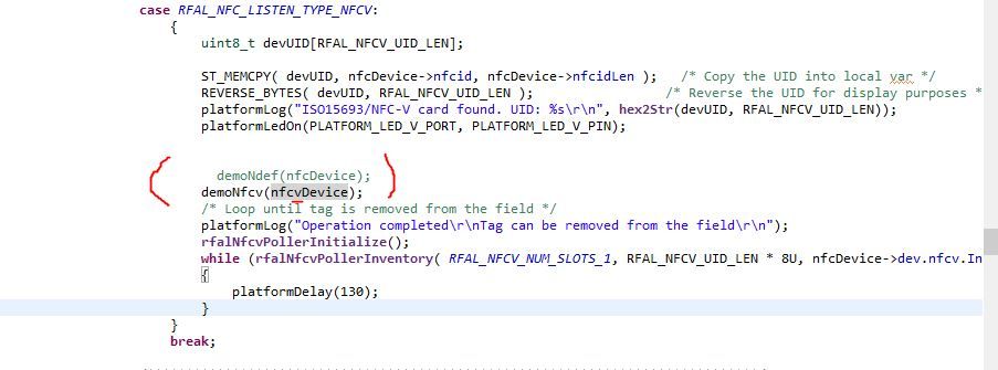

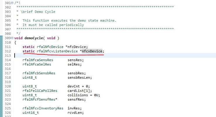

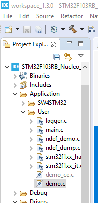

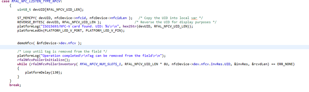

Thanks you again for your advice. I studied the rfal_st25xv.c librarie to understand how I could manage to read and write into the memory blocks. As you noticed me, the demoNfcv() as been created to do so. I tried to use it,I copied/pasted it to the ndef_demo.c file, because i can't run it from the demo.c file (wich has been like excluded from the project) :
I am still using the M24 tag, so I am calling the function at the right place, when an ISO15693 has been detected.
As you can see i have put the demoNfcv function.

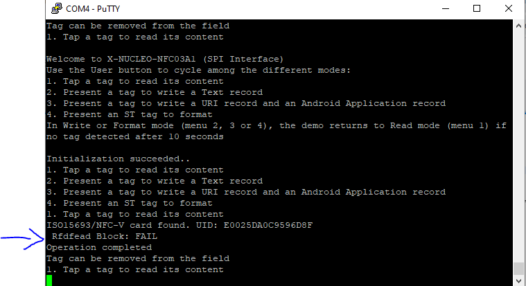

And now i got a read block error, but no error code is returned, so i can't understand why it is failling :

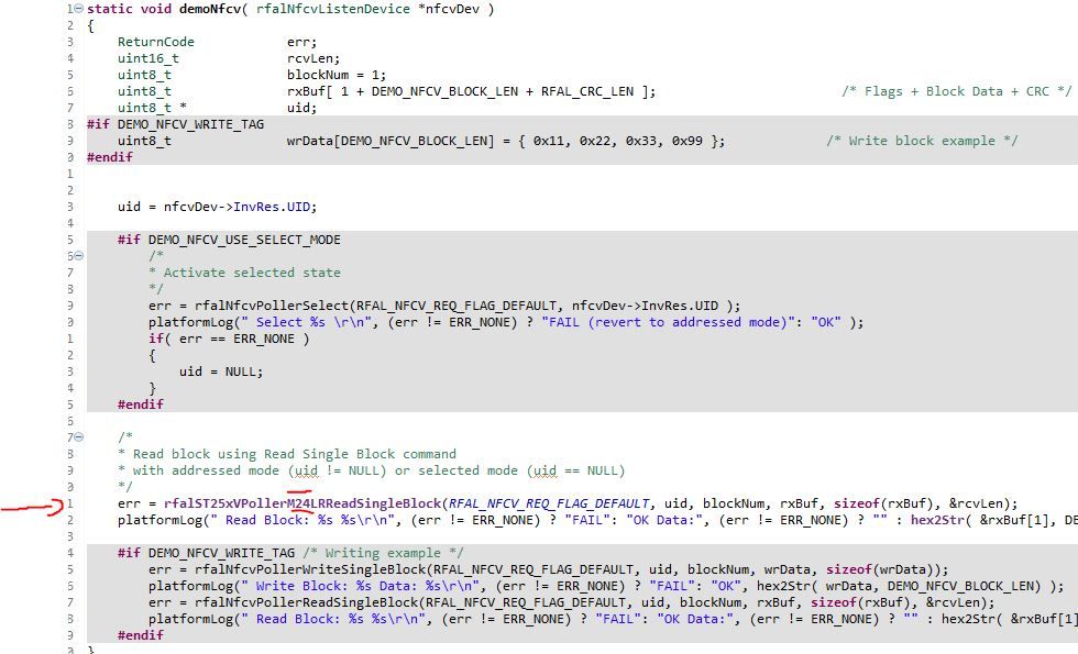

Brian TIDAL
Hi Karim,
the demoNfcv uses rfalNfcvPollerReadSingleBlock() whereas a M24LR64 tags has a extended block number coding.
rfalNfcvPollerReadSingleBlock() works for standard ISO15693 tags whereas rfalST25xVPollerM24LRReadSingleBlock has to be used for M24LR64 or M24LR16 tags.
If you want to read a block from a M24LR16 or M24LR64 tag, you just need to replace rfalNfcvPollerReadSingleBlock by rfalST25xVPollerM24LRReadSingleBlock in the demoNfcv.
Rgds
BT

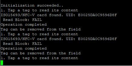

Hello Brian,
I tried to replace rfalNfcvPollerReadSingleBlock()  by the rfalST25xVPollerM24LRReadSingleBlock function. Here in the code (ndef_demo.c) :
I added a static variable with the asked structure :
And I just replaced the demoNdef(nfcDevice) originally in the code by the demoNfcv() .
No error or warining during compilation, but when I am trying to read through the application, still got read block fail :
Best regards,
