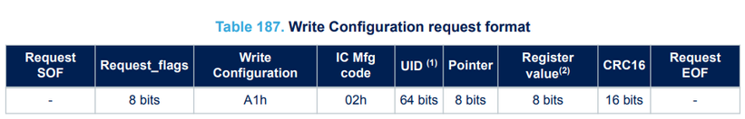

Thank you. That helps a lot. I tried the iso15693HandlerIOS and it seems to be working with iOS. Commands like readSingleBlock are working fine, however, I couldn't execute the custom commands. 15693-3 says I can run custom commands from 0xA0 to 0xDF, which is different for each chip? Anyhow, for instance I want to run the 'Write Config' command (0xA1) to write the RFA1SS register to lock Area 1 using PWD_1. I set up the command like this based on request format:
const res = await NfcManager.iso15693HandlerIOS.customCommand({
flags: 0x02,
customCommandCode: 0xa1,
customRequestParameters: [0x02, 0x04, 0x05],
However, I receive error upon running this command. Is the command not setup properly?

When using the customCommand in iOSCoreNFC, the ICMfgcode (e.g., 0x02) is automatically appended by iOSCoreNFC itself. Therefore, you should not include this parameter within the customRequestParameters.
Additionally, please note that currently, only the non-addressed mode appears to be supported (flag 0x02). I have not been able to successfully send custom commands in Addressed Mode using iOSCoreNFC, and the reason for this is unclear.
Kindly try removing the 0x02 from your customRequestParameters and let me know the results.

Hi Victor,
I tried removing the ICMfgCode from the customRequestParameters. It still fails and returns error.

Hi Victor,
Please disregard my previous response.
I did a silly thing and didn't provide the Present Password command before writing to Config Register.
What you recommended worked well. I removed the ICMfgCode and Presented Password prior to writing to register. It works. My modified code is attached below.
