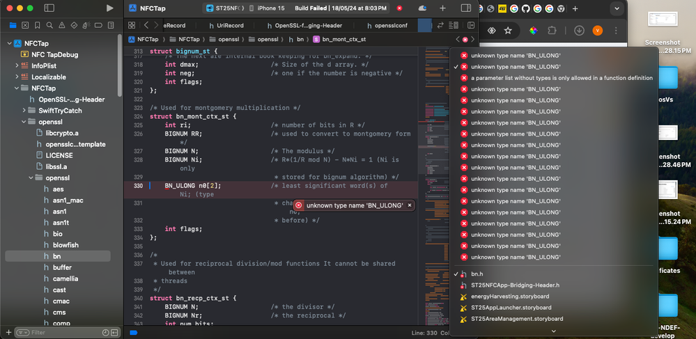

I am trying to compile the IOS NFC tap source code and I am getting open ssl & J2Objc hearder not found errors.
We are trying to read and write with the ST25DV series of tags.
Details
Xcode Version : 15.3
min dev : 15.0
Downloaded source code version : 7.4.0
Does the Source code support the latest versions of IOS?
Any extra steps needed for proper compilation?
Error:
Compilation error
Thanks,
Suresh

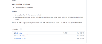

Sorry for late reply, Just wanted to make sure everything is working fine. We can close this thread as it working fine.
Changing to version 2.4 from 2.8 is resolved the compile issue.
Just wanted to iterate all the steps for people new to IOS.
1. Downloaded IOS NFC tap source code(STSW-ST25IOS001) (Version 7.4.0 )
2.Check compatible version of J2OJBC version(2.4 is compatible for 7.4.0)
2.Downloaded Source code from https://github.com/google/j2objc/releases
3. Goto downloaded folder and Build using command $make dist . It took some time and created dist folder with lib,frameworks,include

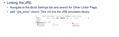

4.Linking JRE also done. Make sure there no inverted colons in path i.e "ljre_emul liconv". Path should look like below.

2024-05-17 12:05 AM
hello ,
Have you included J2OBJC headers and library into your environement ?
Please , check the J2OBJC_HOME variable into Xcode, and update it if needed.
In addiition, check your Header and User Include search path into build setting for your target.
Here attached, a short presentation on how to configure Xcode for iOS NFC Tap and using J2OBJC. Ref to slides #9 => #12

2024-05-22 12:41 AM
hi Suresh,
I redo from clean environment, and all is working fine.
Please, could you check in "bn.h" file in which case BN_ULONG is defined ? THIRTY_TWO_BIT, SIXTY_FOUR_BIT_LONG or SIXTY_FOUR_BIT ?
At my end, I'm using "THIRTY_TWO_BIT".
I have the feeling that none of these are used in your end....
Let me know.

2024-05-23 07:05 AM
I 'm able to reproduce issue only in simulator mode...anyway...
Please, could you tell me which include file "# include <openssl/opensslconf_...." is called in the file "opensslconf.h" ?
