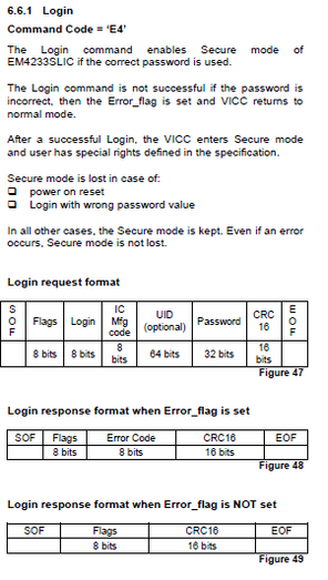

first of all thank you so much. I tried to understand the function.

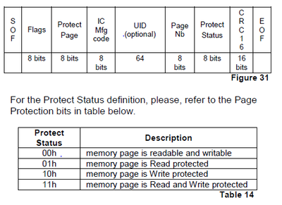

If the request format of a cmd looks different, can the function rfalNfcvPollerTransceiveReq() still be used? For example, how about in this case.
The structure of the function is similar to before, but I don't quite understand how to pass the bits to the Page Nb and Protect statuses. Because in the function: rfalNfcvPollerTransceiveReq() there is only one variable for the data.
Brian TIDAL
this is quite simple. Just create a new function with those 2 parameters (Page and Status) and encode them as a single array before calling rfalNfcvPollerTransceiveReq. This should give something like this.
#define RFAL_NFCV_CMD_EM_PROTECTPAGE           0xzz /*!< EM Protect Page command                    */
#define RFAL_NFCV_CMD_EM_PROTECTPAGE_DATA_LEN  2    /*!< EM Protect Page data len                   */
ReturnCode rfalST25xVPollerEMProtectPage( uint8_t flags, const uint8_t* uid, const uint8_t pageNb, const uint8_t protectStatus)
    uint16_t           rcvLen;
    rfalNfcvGenericRes res;
    uint8_t            data[RFAL_NFCV_CMD_EM_PROTECTPAGE_DATA_LEN];
    data[0] = pageNb;
    data[1] = protectStatus;
    return rfalNfcvPollerTransceiveReq( RFAL_NFCV_CMD_EM_LOGIN, flags, RFAL_NFCV_EM_IC_MFG_CODE, uid, data, RFAL_NFCV_CMD_EM_PROTECTPAGE_DATA_LEN, (uint8_t*)&res, sizeof(rfalNfcvGenericRes), &rcvLen );
If you need to use more custom commands, make sure to create related encoding functions.
Rgds
BT
I've added the features to the tag. However, it is not possible to protect the read or write process yet.
Rgds
maybe it could be that the flags were not set correctly.

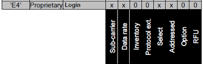

Login:
Protect Memory Page:
