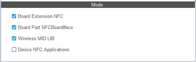

Hi @yeji_jang
welcome to this community.
As your IOC project does not select the Device NFC Applications, the main() function does not call any initialization related to the NFC middleware or initialize the IPs used by the NFC middleware (for example, SPI).
In this case, your application must call the initialization functions. For the SPI, the functions are available in custom_bus.c: just call SPI1_MspInit() followed by MX_SPI1_Init().
Next, your application must register st25r3916Isr() as the callback to the EXTI interrupt connected to the ST25R3916 IRQ pin. Alternatively, you can add a call to st25r3916Isr() in the USER CODE #1 section of the EXTI interrupt handler. If a NUCLEO-F401RE board is used, the ST25R3916 IRQ pin is likely connected to PA0, not PB13. I would suggest checking this point.
Then, rfalInitialize() must be called to initialize the ST25R3916. It is recommended to enable the ST25R_SELFTEST compilation flag (preprocessor define symbol) to add extra checks for SPI communication and interrupt handling.
As your application only needs to enable the RF field, it only needs to call rfalFieldOnAndStartGT().
Ensure that you carefully test the return codes of the various calls.
I also recommend moving to the latest version of STM32CubeMX.
Rgds,
BT
Hi @BT,
Thank you very much for your kind and detailed response — it has been incredibly helpful for someone like me who is just starting with STM32 and NFC development.
I carefully followed your suggestions and made the following changes:
  1. I enabled the "Device NFC Application" in STM32CubeMX.
  2. I configured SPI and EXTI interrupt settings correctly, and I also confirmed that the ST25R3916 IRQ pin is now connected to PA0 as advised.
  3. However, I’m currently facing an issue where rfalInitialize() doesn’t seem to execute properly.
    I suspect it may be related to a missing header file — although the rfalInitialize() function is defined (in rfal_rfst25r3916.c), I couldn’t find a corresponding .h file that declares it properly. This might be why the compiler doesn't fully recognize the function, even though no warning appears when I call it.
As a result, I believe that rfalFieldOnAndStartGT() isn’t being triggered either, and the RF field never gets turned on.
  1. I also defined the ST25R_SELFTEST compilation flag, but I’m not quite sure how to correctly use or verify it.
    Could you please explain how this flag is meant to help with SPI communication and interrupt handling checks?
  2. Finally, I have updated to the latest version of STM32CubeMX, as you suggested.
I’ve been trying to troubleshoot this all day, but I’m still not sure what’s going wrong.
I would deeply appreciate your guidance on what to check or fix next.
Thank you again for your patience and support.
Best regards,
Yeji

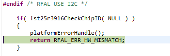

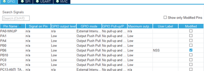

Thank you for your prompt reply.
I have already included "rfal_rf.h", and make breakpoint at st25r3916Initialize()
I found Initiatlization is failed, strongly assume that the ChipID is not properly read.
I’m currently seeing two related issues:
1.
ret = st25r3916ReadRegister(ST25R3916_REG_IC_IDENTITY, &chipID);
always returns chipID == 0x00
2. Inside demoIni(), rfalNfcInitialize() returns RFAL_ERR_HW_MISMATCH (–36), which indicates that the IC ID check failed.
Would you mind taking a moment to review my SPI initialization and GPIO configurations to see if there’s anything I may have overlooked? I would greatly appreciate any guidance or suggestions you could offer.
Thank you very much for your help!
Brian TIDAL
Hi
The Clock Phase should be 2 Edges (see datasheet section 4.3.3 Serial peripheral interface (SPI))
Also check the Prescaler to not exceed the maximum baud rate.
Ensure that you carefully test the return codes of the various calls (MX_SPI1_Init, etc.).
Rgds
BT
