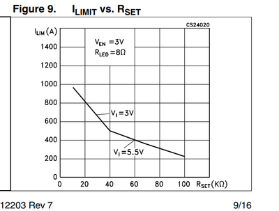

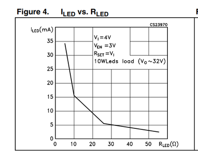

Hi Peter,
Thanks for your feedback.
Could you help share the equation of  ILIMIT and RSET, ILed and RLED?
I cannot find the equation in datasheet.
