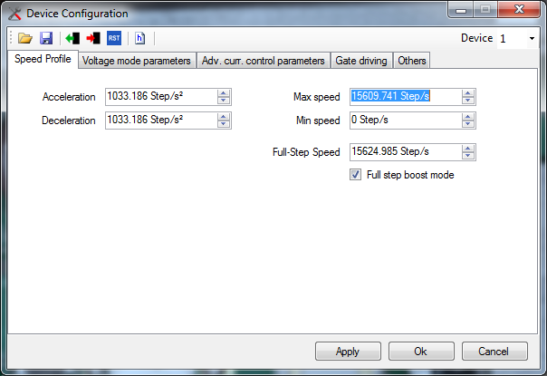

What is max speed of POWERSTEP01 in steps/sec?
CBeif.1
In the STPSIN software, it seems that I am limited to 15609.741 Steps / sec?
(See picture below)
With a 0.9 degree motor (400 steps / revolution)
this limits me to
15609 steps/sec * 1 rev/400 steps * 60 sec/1 minute = 2341 RPM
Is this the maximum speed of the device, because I need to move at 3000 RPM?
Is this for trajectory mode only? Can I move faster if I provide the external step pin?
Is there a fundamental speed limit for step mode?
4 REPLIES 4
Enrico Poli
That is the maximum speed allowed by the integrated motion engine, i.e. the logic processing the SPI commands like GoTo, Move, ...
Using the StepClock mode (see stepclock command in the datasheet) you can overcome this limit.
Maximum step-clock frequency is about 1.5 MHz.

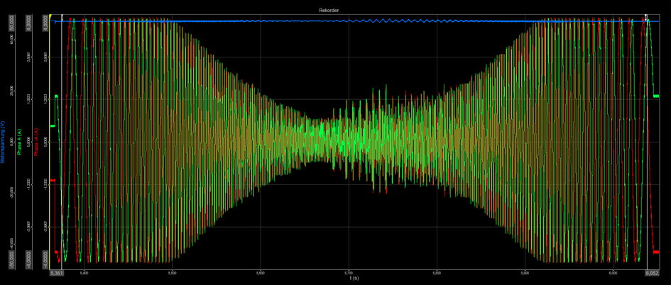

I have a similar problem. The motor current drops at higher speeds.
  • Current mode
  • step clock mode
  • 1/16 microstep
  • 48 Volt
I have set a low acceleration for testing. Everything is fine up to approx. 16 kHz (microstep). Then the current drops further and further. The maximum speed (in the center of the diagram) is approx. 44.8 kHz. That's only 840 rpm.
1,8 [°/step] / 16 [microstep] = 0,1125 [°/microstep]
0,1125 [°/microstep] * 44800 [microsteps/s] = 5040 [°/s]
5040 [°/s] / 360 [°] = 14 [1/s]
14 [1/s] * 60 [s/min] = 840 [rpm]
This is the current configuration:
OCD_TH = 31
FS_SPD = 100
STEP_MODE = 12
GATECFG1 = 226
GATECFG2 = 96
CONFIG = 45952
TVAL_HOLD = 55
T_FAST = 17
TON_MIN = 4
TOFF_MIN = 4
What do I have to set so that the current always remains the same and does not drop?
