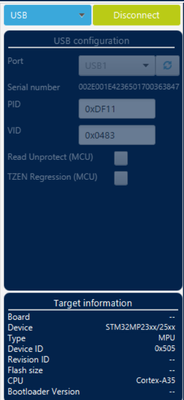

Hello all,
I am following the following guide: https://wiki.stmicroelectronics.cn/stm32mpu/wiki/STM32MP25_Discovery_kits_-_Starter_Package In order to bring up a STM32MP257F-DK board and am running into a problem when I try to use the Programmer to flash the board. It gets to Partition 0x3 and at 31% fails saying it failed to download sector[0]. Specifically this is the output in the terminal:

Hi @Gregory PLANCHON & @PatrickF
I figured out the problem, it seems that the USB port I was connected to, on the front of my PC was a 3.0 USB which apparently doesn't work and I needed to connect it to a USB port on the back of my computer. I can flash it now! Thank you both for your help.

Hi @Gregory PLANCHON,
After going through again it still gives me the same error, below are some more specifics on each of your bullets:
On the prerequisites, I have done all the steps it mentions about installing and setting up the programmer tool and I have setup the USB for serial flashing. It doesn't mention in that chapter any other prerequisites so I assume that is good. I also did some of the prerequisites under the PC prerequisites tab although it seems those are only for Distribution and Developer packages and not the Starter Package.
On the connected to cube programmer, I have tried flashing in the GUI and in the Terminal, and if I connect in the GUI then try to flash in the terminal it doesn't work saying target device not found. Either way the Programmer seems to work.
On the directory, specifically my directory when I try to flash is /Desktop/STM32MPU-Ecosystem-v6.1.0/Starter-Package/stm32mp2-openstlinux-6.6-yocto-scarthgap-mpu-v25.06.11/images/stm32mp2. I assume that's fine, or does my Starter package need to be in my home directory?

Hi @Carson ,
Have you configured the boot pin as described on the wiki page?
Could you also try reinstalling the starter package from scratch by downloading the latest version and using the tar command?
Could you also let me know what command you used for the script?
Regards,
grégory
HI @Carson ,
COM led is not very meaningful.
You should have red led LD7 blinking until PC is recognized on 'USB DRD port' (so blink once if USB is already connected). But as the flashload seems to start correctly, there is probably no issue here.
Some points to check below:
Check/replace your USB cable.
Check/replace USB supply.
Confirm PC USB is connected on CN16 'USB DRD' (and USB supply on CN21 'USB PWR STLINK').
Check cubeprogrammer command line you are using
You mention that CubeProgrammer GUI should does not connect. Please check you use 'USB' in the blue dropdown box.
Did you try flashing on a windows PC or another machine ?
Does it always fail at 30% of the "fip-stm32mp257f-dk-optee-programmer-usb.bin" file ?
Which version of the board are you using ? Should be MB1605C on the PCB and MB1605-MP257F-C01 on the sticker ?
If possible, dump of the STLINK UART console during flashing might help to identify issue.
embeddedbro
I face similar problem and after connecting to the back panel of PC it magically worked!
