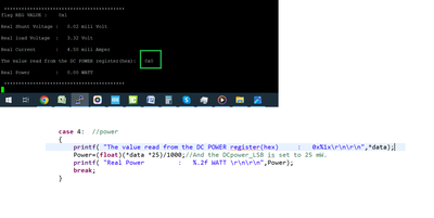

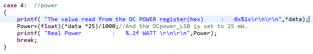

the decimal value I got from the recording is zero. therefore, the result of the multiplication used from the calculation of the actual power is also zero
fog.1
I am printing the value I read from the recording on the screen. the value returns as zero.
Sorry - I corrected the post:
What you're printing here is somehow arriving via a pointer - have you checked the point at which it's actually read from the chip?

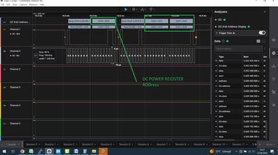

ret = HAL_I2C_Mem_Read(&hi2c1, (uint16_t)0x81 , (uint16_t)REG, (uint16_t)1, Read_reg_data, (uint16_t)2, 50);
I perform a read operation with a length of 2 bytes and the value read from the
corresponding record is transferred to the variable "read_reg_data". the content
of this variable is zero when the reading process is finished.

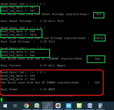

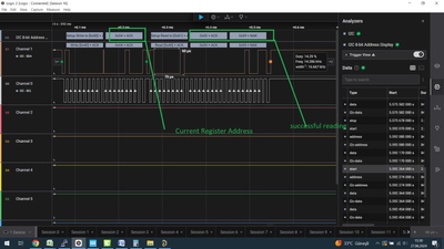

I'm checking the "rejection" value. there is no mistake. the rejection value appears as "HAL_OK". in addition, everything is normal when I check the "SDA" line on the "I2c" interface with the logic analyzer.
 the same "I2C" reading function is used in these two operations. he from both "return= HAL_OK."
as I said, all other recording values can be read successfully, but only the "dc power recording" value returns as zero when the reading is done.
