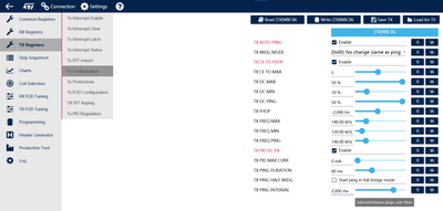

Hello willzhou,
First of all, I want to thank you for your response. I have tried various attempts both with the STEVAL-WBC86TX and with my PCB, setting the "TX PING INTERVAL" parameter differently as you suggested, and I also tried clicking "TX PING HALF BRDG", but the issue has not been resolved.

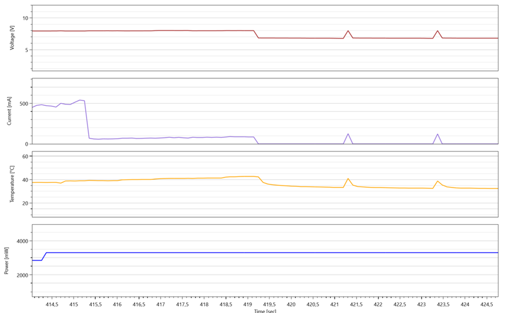

In addition, I have conducted further tests with default parameters on both boards (both the STEVAL Evaluation Board and my WBC86TX PCB), and I have recorded the following charts directly from WPSTUDIO's "Charts" feature, hoping they may be useful to your community in assisting me with resolving the issue:
DZaot1_0-1712826046196.pngFIG 1
FIG 1 depicts the operation of the STEVAL-WBC86TX: after a certain runtime (approximately 419 s), as indicated by the "Voltage" graph, the system transitions from 8V to 7V when the receiver is removed and returns to the PING phase.

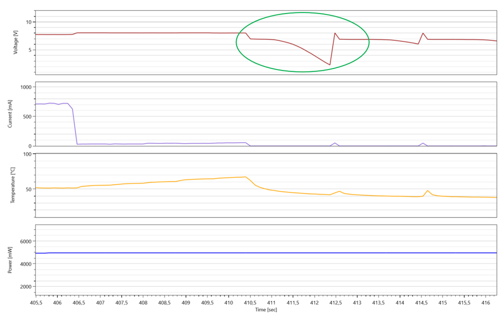

Now, considering the following graph referring to my PCB (WBC86TX):
DZaot1_1-1712826113924.pngFIG 2
FIG 2: Initially, the board was functioning correctly as it transitioned from the transmission phase to the Ping phase. However, after a certain period (approximately 410s), the Voltage dropped significantly before returning to the Ping phase. After bringing the receiver close again, the system became stuck, as described earlier.
