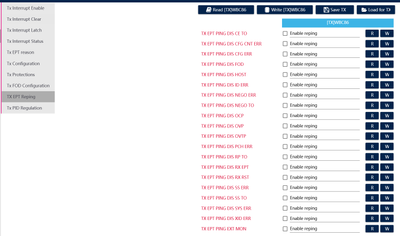

I have a array of 2x5 STWBC86 on a aluminium plate to make a charging station for multiple devices. They are all connected to a common 5V source and decoupled by a small filter of Ferrite bead and MLCC.
After testing them for a while i let them rest over the weekend with no devices sitting on the chargers.
After that only a few of the STWBC86 work correctly, the rest doesn't respond to devices. I connected WPStudio and found no errors to be shown but what i found is that the device has its power stage active all the time at its ping frequency.
Best regards

Hi
I have check default cfg,
when TX detect three occasions.
  1. FOD
  2. OVP
  3. SYS ERR
It will disable re-ping, so TX will not ping. It need MCU/AP to clear this state and set command to "TX Start".
I have update new cfg and disable ept reason, please use this link cfg file
https://github.com/STwirelesscharger/STSW-WPSTUDIO/blob/main/STSW-WBC86FWBPP/STEVAL-WBC86TX_config_120D_BPP_NoEptReason.memh
After update this cfg file, GUI show all TX EPT Reping is disable.
willzhou

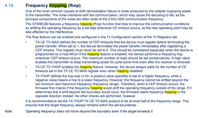

Based on manual
https://www.st.com/resource/en/user_manual/um3161-getting-started-with-the-stevalwbc86tx-wireless-power-transmitter-evaluation-board-for-up-to-5-w-qibpp-applications-stmicroelectronics.pdf
It maybe tx stuck in fhop feature, change frequency and stay in power-stage mode.
if i understand correctly Fhop is enabled by default.
so you reccomend to disable Fhop feature?
Best  regards
Stefan
yes, i recommend to disable  Fhop feature, attach is cfg for your test.
