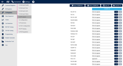

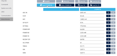

‎2024-04-12 01:24 AM
i could recreate it within a day.
Please find the screenshot below:
as well see a shot of the mode monitor:
RX and TX powers values are misleading in correlation to ICUR.
I also looked at the TX Interrupt latches and did find that if i write to "Did not occur" further testing does not alter them wich is different in a Controller not in that "error" state.

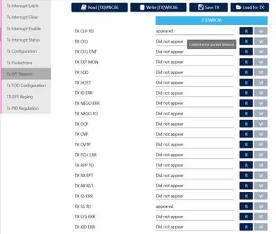

‎2024-04-12 01:35 AM - edited ‎2024-04-12 01:37 AM
HI
From your picture, TX get cep timeout, which mean do not get RX Control error packet, So TX will cut off power.
Seems TX/RX communication is bad, What is RX output voltage? Do you use STWLC38-EVK for RX?

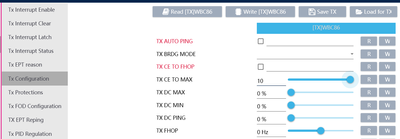

How about you adjust TX input voltage, set higher like 6V and try it.
Also you can use GUI and set "TX CE TO MAX" to 10, make cep timeout less to happened.

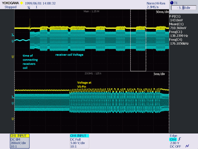

‎2024-04-12 01:42 AM - edited ‎2024-04-12 01:57 AM
thanks for the swift reply.
i checked with a scope. the TX is still on (even if RX is removed). This will carry on forever until i reset the controller. Also i guess the CEP is there because of the removal of the RX on the previous charging cycle.
I use an IPhone for testing as well as Ti bq51050b. RX rectifier voltage is perfectly fine (5V) as well i checked the voltage at the VS pin of the TX. (DC-Level and AC component)
never the less will check with higher voltage.
‎2024-04-12 02:13 AM
Hi
Sorry I have mis-understand your issues.
Your issue is when RX remove, TX still in power transfer phase.
TX will get cep timeout and remove power Normally.
But your TX have some problem. So you need to modify set "TX CE TO MAX" to 0, make it easy to detect RX removed.

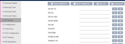

Please give me abnormal TX "TX EPT reason" GUI screenshort.
About clear latch intr, you need to use "TX interrupt Clear" in GUI.

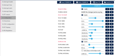

TX default cfg is ping interval is 2sec, ping during is 80ms, So FW will do like this
1.ping 80 ms
2.Not find RX packet, sleep 2sec
3.Go to step1
Default TX CE To Max is 5, It means if ce timeout >5 it will go back to sleep,
So i think abnormal TX is detect CE packet and will not go to sleep.
So i suggest you set this value to 0 and test again.
‎2024-04-15 05:49 AM
i will try and give you feedback asap.
the WPSTUDIO doesn't let me set 0 so i will try with the minimum which is 1.
