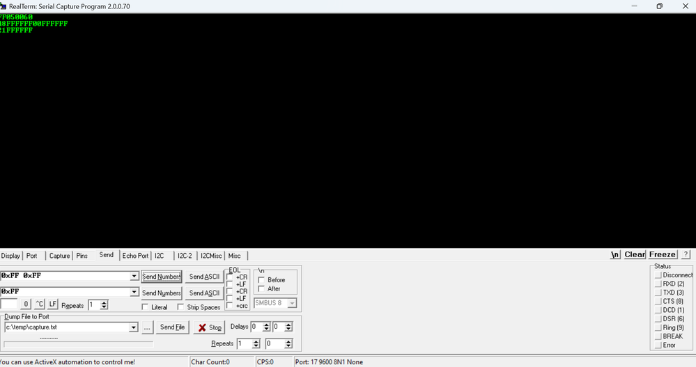

I have developed code in arduino IDE , I am only getting the output receive from UART 04000A075 . I understand that this is the default value in register DSP_CR1. Could someone please tell me what does this mean.
I hereby provide the code for receiving and transmission of signal from STPM34 to ESP32 using UART.

‎2025-01-06 10:14 PM
I have tried using Real term to send command frames in the format 0xFF,0x00,0x60,0x00 to write data in to registers of STPM34. Also checked if it gave back any response if I send 0x0A,0xFF as in the datasheet of STPM34 it is mentioned that when we are sending a data to read a register of STPM34. If it receives an address value first it gets ready that register to send a data after receiving next value. When I checked STPM34 using Real term I connected Rx and Tx of STPM34 to a TTL. But I was unable to receive any response.
When I used ESP32 to write and read data from STPM34 I used the method used in the code given above and also tried to read the data byte by byte, but this was also unsuccessful.

Here I connect STPM34 Rx and Tx to a TTL and communicate using Real term, and I send data in this format to get a response. Correct me If it is wrong approach to debug the issue.
‎2025-01-07 5:34 AM - edited ‎2025-01-07 7:39 AM
I have also attached an example of a first typical UART access.
You can see that the answer on RX is 0xA0 00 00 04 75 (CRC).
I hope it helps.
