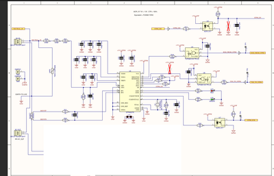

I am facing the exact same issue, with a single STPM32 in UART mode. I have created a case (#00252353), but Ted Thompson, the employee assigned to the case, suggested I open a new forum post. Seeing as this post describes my exact problem, I would like to jump on to follow up.
Did you follow the initialization procedure during power-on sequence, with SYN and SCS pulse to reset the chipset  after each power off/on ?
No, and connecting them to our microcontroller now would require a board revision. We are pulling SYN and SCS up as per the schematic from the datasheet.
We reset using the EN pin, and then write our full config over UART. This has been validated on the support case:
Regarding your question about SCS and SYN: the STPM32 does not require SCS and SYN to be connected to the microcontroller in order to perform a remote reset. A hardware reset can be done via EN, and a “soft” or remote reset can be triggered through the UART by writing to the appropriate control registers. SCS is used for the SPI interface chip select, and SYN is used for synchronization in multi‑device or line‑synchronization applications; simply pulling them high is acceptable if SPI and external synchronization are not used.
Note that we using software latching, given that SYN and SCS are not connected to the microcontroller.
After some run time, or during a switching event (there is a relay downstream of this circuit), the device resets. We detect this as a timeout over UART, seeing as our runtime baud rate is 115200, and the default for the STPM32 is 9600.
Please advise! I can post more information as required.

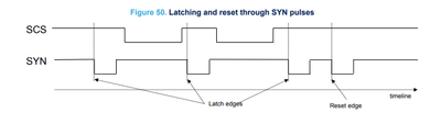

Coming back to the reset sequence, the reset pulses on SYN and SCS described in the starting guide attached are mandatory after each power-on. I am sorry that you got a wrong information previously.
If you want to save 1 opto-coupler, in UART mode, it is possible to generate the SCS signal from SYN + TXD signals using 2 diodes (I will provide you the HW workaround + a FW example in the case).
If you connect SCS and SYN, driving EN signal is not mandatory, it can be pulled-up (so you would not need any additional opto-coupler compared to your actual design).
And as a protection against pulses (like the ones generated by a relay), we recommend adding the RC filtering (100nF+150pF+100ohms+22K) as in our eval kit : STPM32V2
Another recommendation is to place the relay as far as possible from the STPM32 and to carefully design a good ground plane.

I agree that the reset sequence should be described in the datasheet as mandatory.
The reset based on SYN + SCS pulses will ensure a correct reset of the DSP, preventing from calculating wrong values . But you are right, it the chipset is submitted to a "failure event" (a high noise generated by a relay), you have to detect this failure and apply a new reset sequence. So layout is important to avoid this case.
You will find a basic metrology code example including the reset sequence on st.com : STSW-STPM002 | Product - STMicroelectronics
Concerning SYN, if you apply the proposal to save an opto-coupler, using SYN signal for HW latching requires to reset the pulses counter after each latch with 1 SCS pulse as you guessed it (see starting guide).
If you do not use HW latching, SCS can stay high after the reset sequence (use case here is UART mode).
