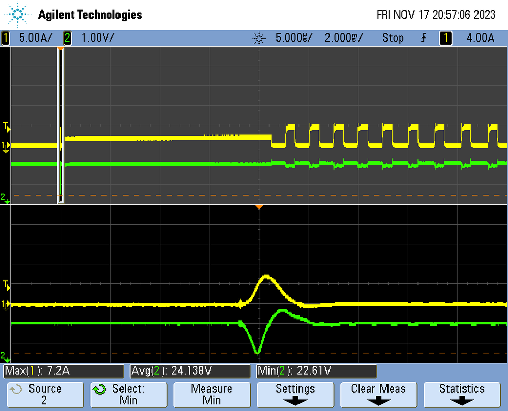

Finally i owned the STEVAL-EFUSE01 and measured what i needed by myself. Setup was a 24V 10A PSU, unmodified evalboard, auto restart jumper inserted. Current probe was 50mOhm shunt. See the picture below. It is a input current (yellow) and input voltage (green) while STEF01 output short-circuit. Short-circuit peak is nice limited to 7A, reaction time is in microseconds. After 8ms thermal protection start to cycling the output current. Hope it will help someone.

Well, STEF01 should not be confused with a classic fuse because it offers considerably more extensive functions.
The response time of the STEF01 cannot be found in the data sheet because it depends on the ambient conditions, the settings and the external circuitry. The last two points are reflected in the data sheet, section 5.1.4 (Current limit), the first is discussed there in section 5.2 (Protection circuits). In addition, it must be taken into account that the thermal protection is also influenced by the current load and the ambient temperature. All of this is application-specific and therefore not part of the general data sheet.
