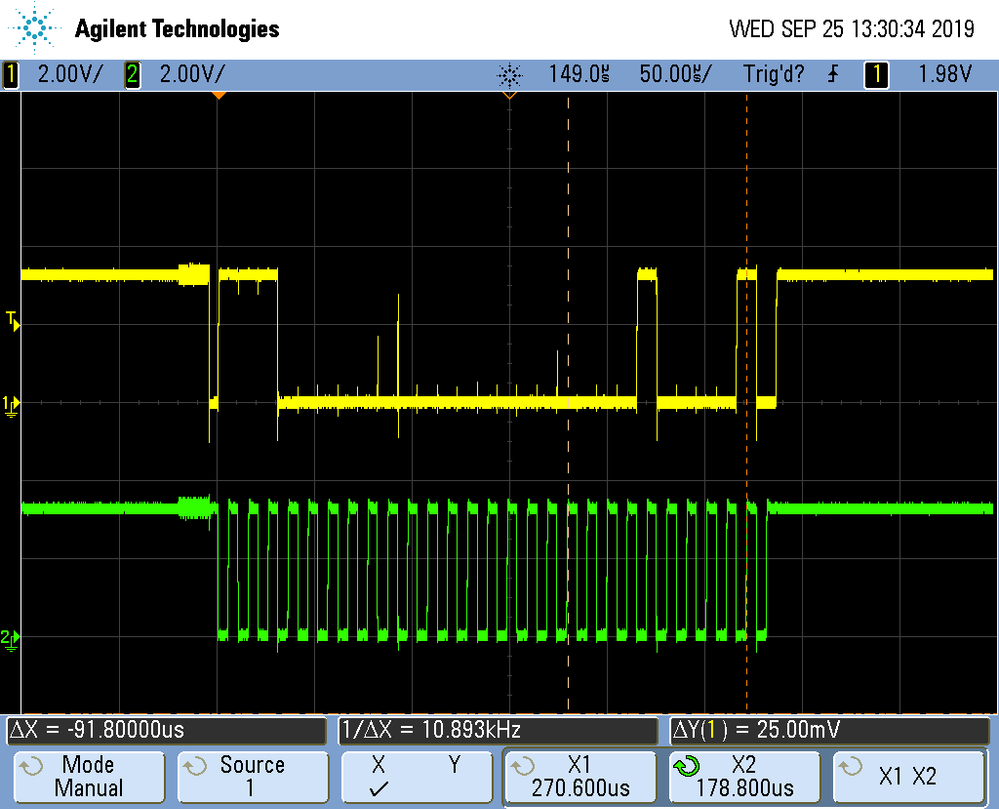

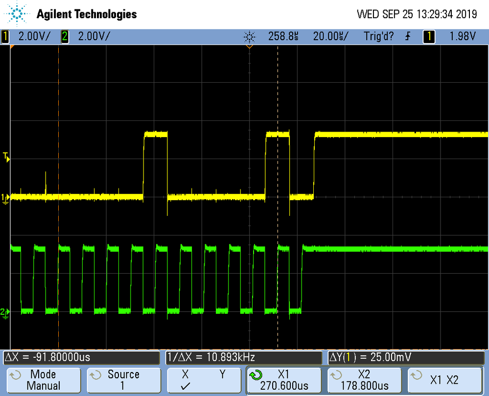

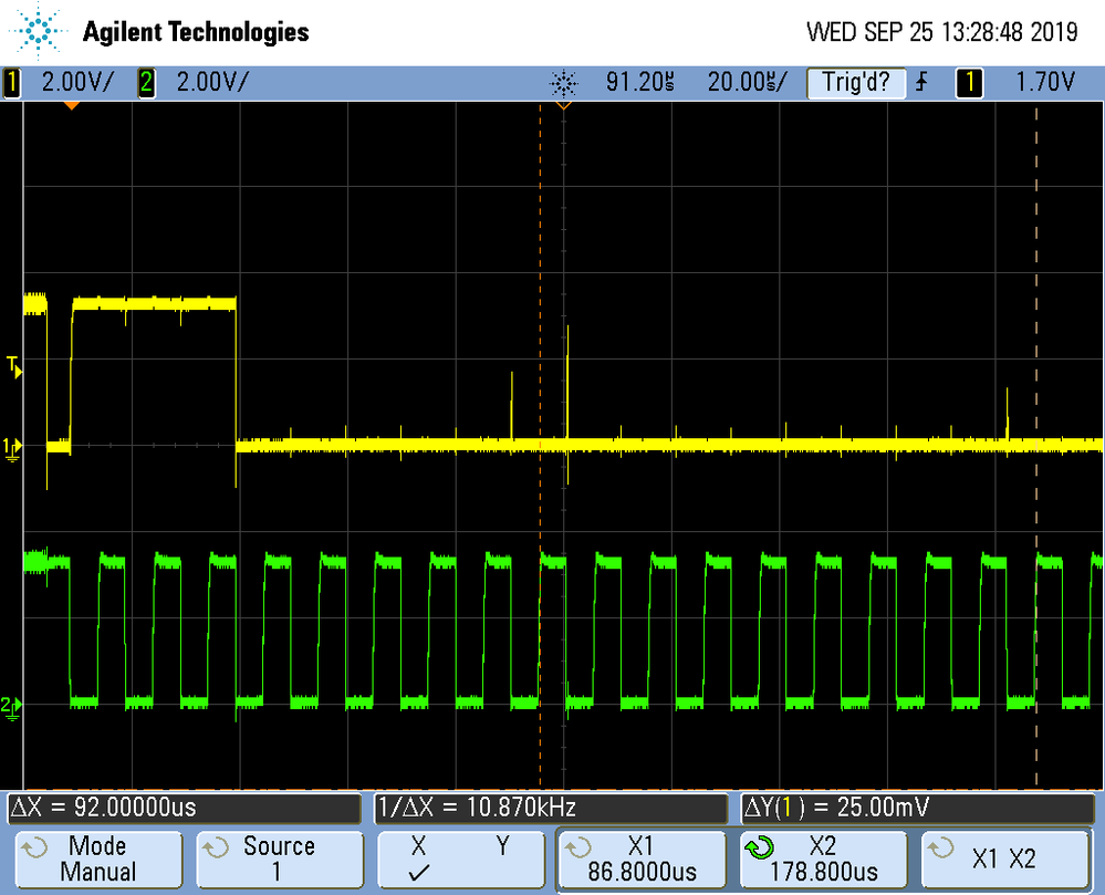

I'm facing some really weird problem with STC3100. After powerup I try to enable operating mode by writing 0x10 value (GG_RUN bit) to register REG_MODE at address 0x00. I2C address is 0x70 as default. STC3100 sends ACK for I2C address, also for register address, but NEVER for data byte, i.e. I never get last ACK. I tried to change clock frequency 10KHz/100KHz/400Khz without any success. How that can be?
Same magnified:

I believe that I have tracked the problem down to the part being in under-voltage lock-out
When the power to the part is below the threshold of 2.7 volts - I can't write the registers.
Above a threshold - it works.
What I am seeing now is the part sees any short excursion below the threshold, and immediately goes into lock-out.
I will add an R-C filter for the power in the future.

A possibility is that the edges of SCL and SDA are too steep. A possible solution is to add resistors on SDA and SCT to reduce the edges.
