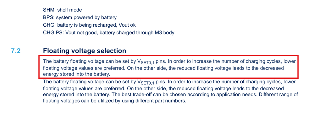

Another thing to improve...
Floating voltage selection explanation (page 11) has a repeated paragraph
Regards,
