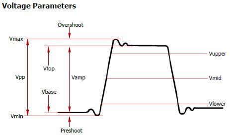

In UM2022, Appendix C Motor electric constant (Ke) measurement written:
"Measure the peak to the frequency ratio" (by oscilloscope).
Our question: what voltage to measure EXACTLY ?:
Vpeak-to-peak, Vmax, Vmid, etc ??
I think it's fundamental to get the right result.
See attached picture coming from a Rigol scope user manual -to see what I mean:
0693W00000JO82BQAT.jpgThanks in advance,

This is indeed a little irritating at first glance. The information from Rigol is not really helpful here, because it refers to the shape of a pulse, with no reference to a zero volt line. However, the output voltage of a stepper motor is a zero-balanced sinusoidal voltage.
But as you can see in UM2022, fig. 54, the peak voltage (marker 1, 2.526V) actually refers to the peak voltage of one half-wave, i.e. not to the peak-to-peak voltage (please pay attention: the zero point for the time measurement is marked by the small red triangle in the upper right corner).

Something like: "Measure the zero to peak voltage (Vpeak-to-peak /2) ..
or make an additional signs to picture , e.g.:
m'I right ?

Regarding Rigol picture in my prev. message (I use 4 types of oscilloscopes: believe me -I know you know- display of every scope is different.): the only reason was to show it: there are a lot of types of voltage 'peaks'.
