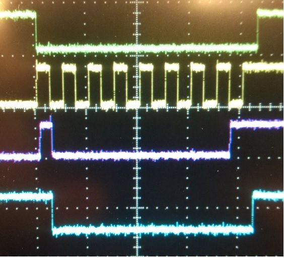

I am facing an issue where it seems the L6470 drops the most-significant bit of each byte transferred when I GetParam ABS_POS.
Here is a screenshot of the SPI comminucation during the last byte transferred when the ABS_POS is at 0.  To me, L6470 is writing 0000 0001 (binary) to the line.  It seems only 7 bits are transferred before the SO goes back HIGH... or L6470 is seeing the rising CK edge prior to the CS low event.  When I zoom in, I see the CK goes HIGH on the first edge approx. 30ns before CS low.
Does anyone see anything in this image that helps explain the behavior?  Or an I missing some configuration needed for ABS_POS to work correctly?
Thanks for any help you can provide.  Right now, I'm stumped....
Jason.

Sorry, I'm missing some key information for reading the image:
GREEN = CS
YELLOW = CK
PINK = SO
BLUE = SI

For anyone interested,
I got this working.  The issue is that the L6470 did not like the CLK signal going low between writing the GetParam ABS_POS and each read byte.
I had to change the SPI driver on the host to maintain CLK HIGH throughout the transmission.
Hope this helps others if you have a similar problem.
Jason.
