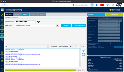

I'm using a working + tested board with the STM32H503KB; connecting over SWD via an ST-Link board. I'm on MacOS and using version 2.16 of STM32CubeProgrammer.
I am attempting to use the programmer to write a SHA256 password hash to OTP memory, in order to configure debug authentication. Without this, I cannot progress the product state to Provisioning or higher without losing device access. I am finding I am unable to perform this through either the GUI or CLI.
First, I'll describe what happens in the GUI. I successfully connect to my target, enter the Secure Programming section, and click the PROV tab. I enter a password, choose an existing directory for the password file to be saved, and click Start Provisioning. Here is a screenshot just before I click the button.
When I click Start Provisioning, the window instantly closes; no error dialog is shown.
